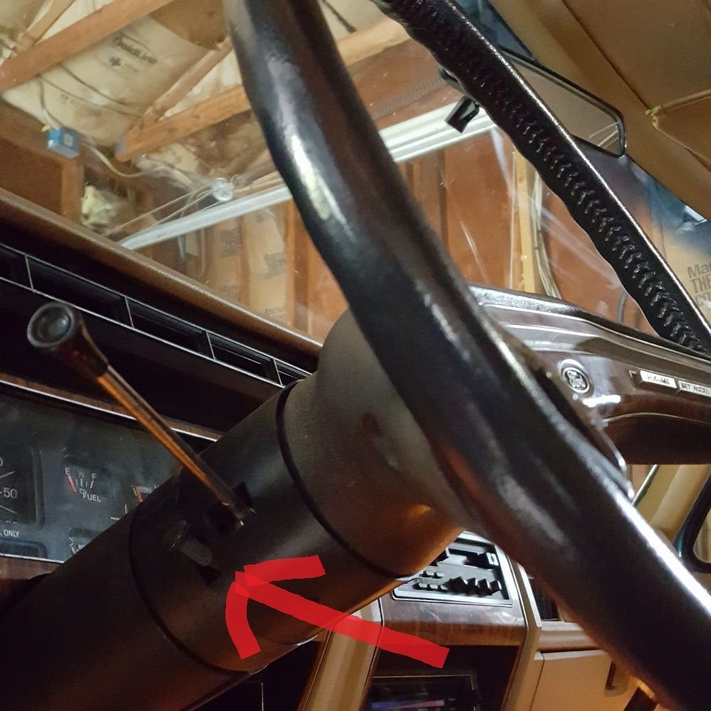

Here is mine. Follow the red arrow......

Mine looks like the automatic column, so that's probably part of the confusion. Now as far as getting the key out, does the button have to be depressed to remove the key, or to even get it to the off position. My ignition currently won't turn far enough backwards to line the arrow on the collar up with the word lock on the new cylinder.

You need the release in order to turn the key to the LOCK position, which is when the cylinder collar tabs line up with the LOCK> indicator. This locks the column and allows you to remove the key. The next click backward (counterclockwise) from there is ACC. You'll probably have to remove the wheel and find what that button releases and release it manually, then figure out how to fab something in, or permanently activate that release.
Vehicles with manual transmissions have had this mechanism for decades. Most likely a federal regulation. Either you have to push the key toward the column, or activate a release, to turn the key all the way back. The OBSes have it, but the button is right next to the key cylinder instead of on the other side.
