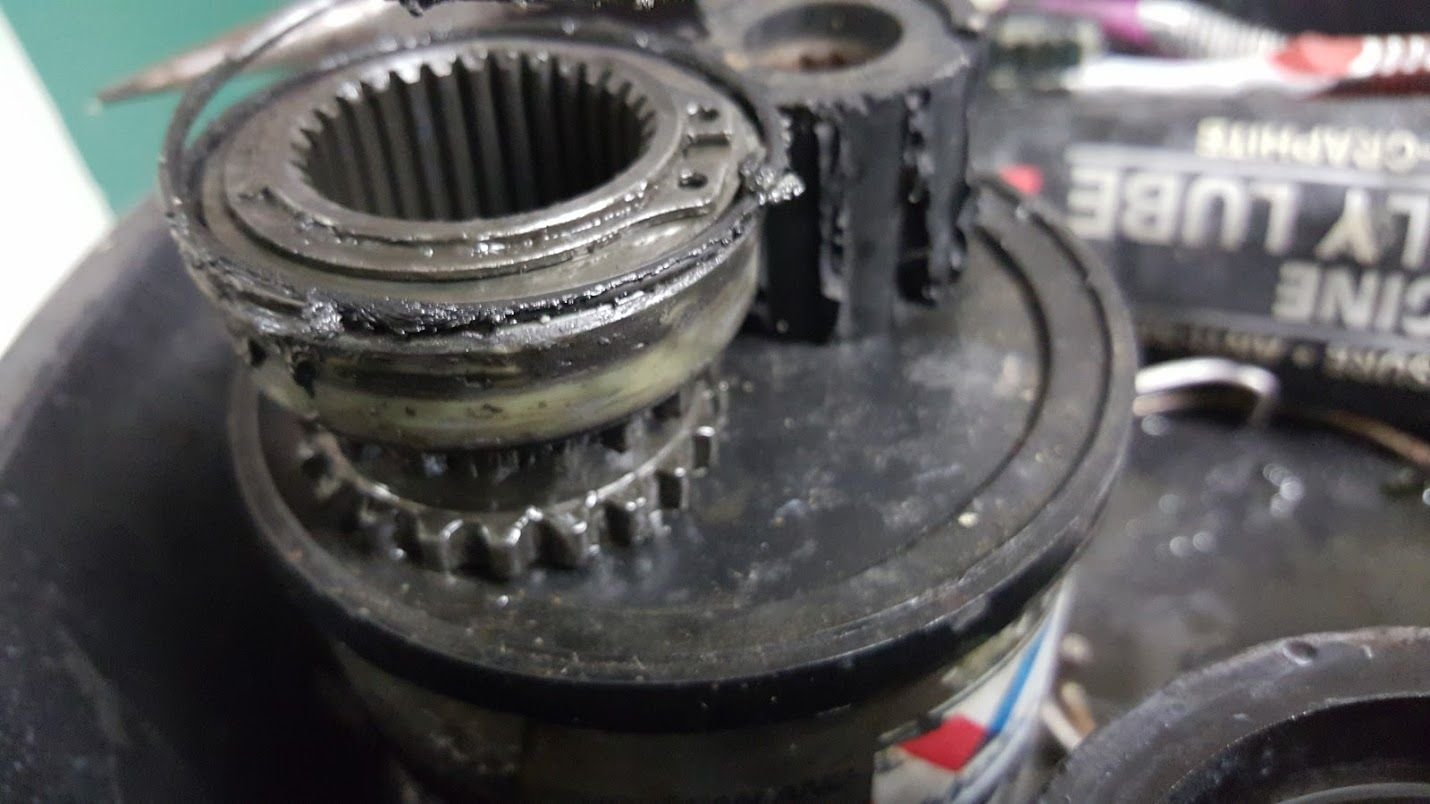

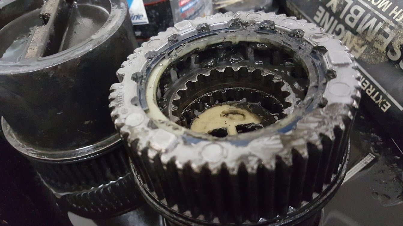

Here is where the spring was installed incorrectly; it was static while the hub is spinning with the wheel/tire. The spring ate through the plastic part that you are missing.

I could NOT Find this part anywhere; they were not made.
Dorman was just coming out with their HUB replacement that is complete and you can find for about $150 ea.
I kept the OEM hubs and put a post out on this forum. Ended up buying a set from a guy that were in need of service. $60 to WI from TX and I had the plastic part I needed.
Pull them all apart and clean/lube/ reassemle and you will have OEM quality hubs!
