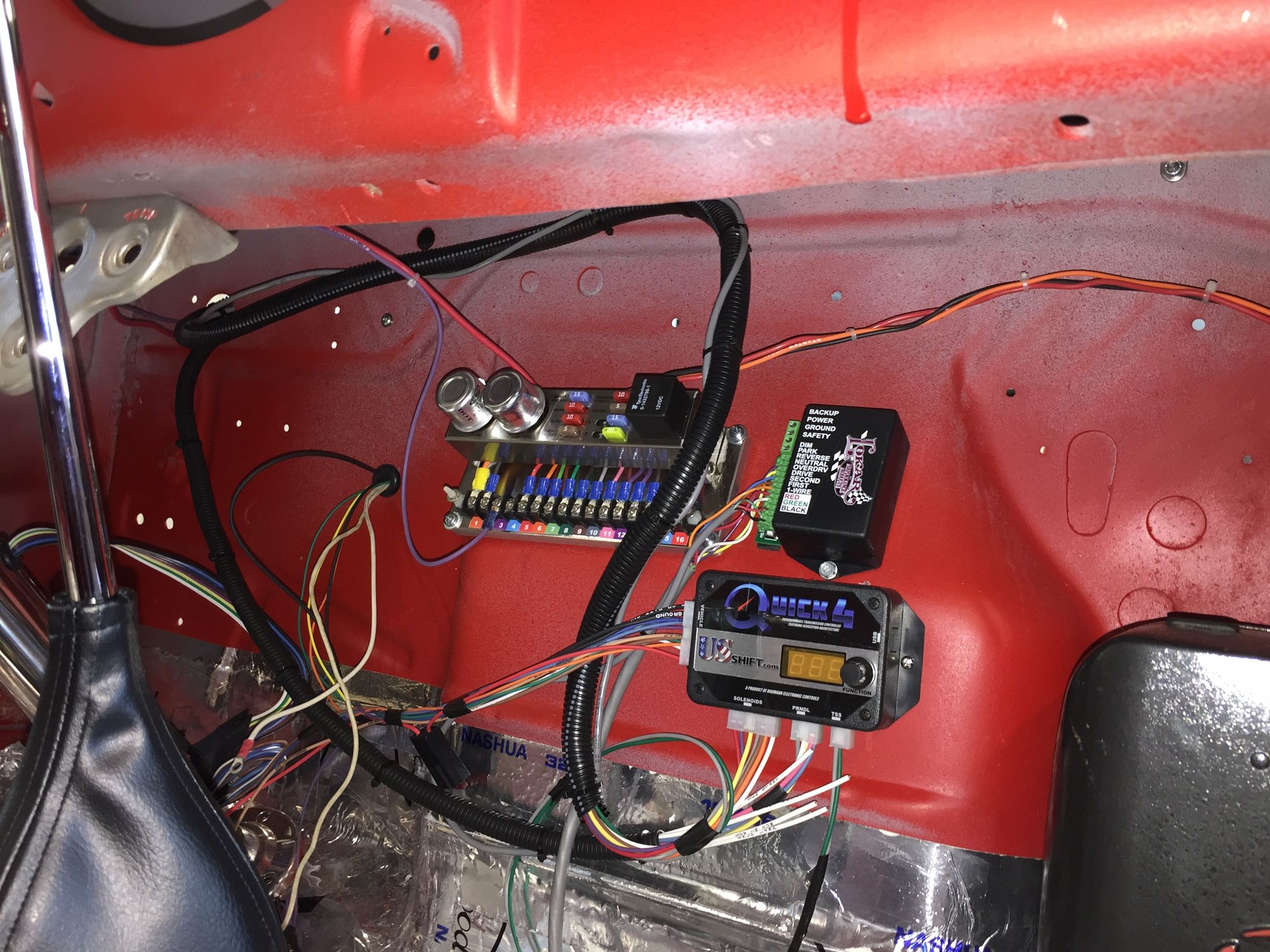

As you can see I am currently installing the wiring as things are not yet as neat as they will be. I installed the fuse panel inside in the middle of the firewall with the US Shift transmission module and the Lokar shift indicator modules right next to it where they are protected but easy to reach. I'm using the Ron Francis Bare Bonz kit and the wiring precut lengths seem to indicate this is the location they would recommend. The same with the US Shift harnesses as I have not had to modify any of their harnesses. The electronic 4R70W has almost more circuits than the rest of the truck but all the kits come with good instructions. Only the neutral start circuit has needed some interpretation.

Hey Pete,
for what is that Lokar and that Shift thing box?

It's for lighting up or indicating what gear you are in..https://www.lokar.com/shift-boot-indicators.html

That is the programmable trans shift controller made by Baumann U.S. Shift.

Ok, but what is the sense, i mean for what is it, what does it?

If you are running an older engine with no computer sensors (ECM/ECU/MAF/trans control, etc) but are running a transmission that requires these inputs in order to shift, then this module simulates the engine sensors. For instance, a friend is running a built 312 Y-block in his 56 but he wanted a late model 4R70W automatic transmission behind it...he uses the Baumann unit to make the transmission shift correctly.
