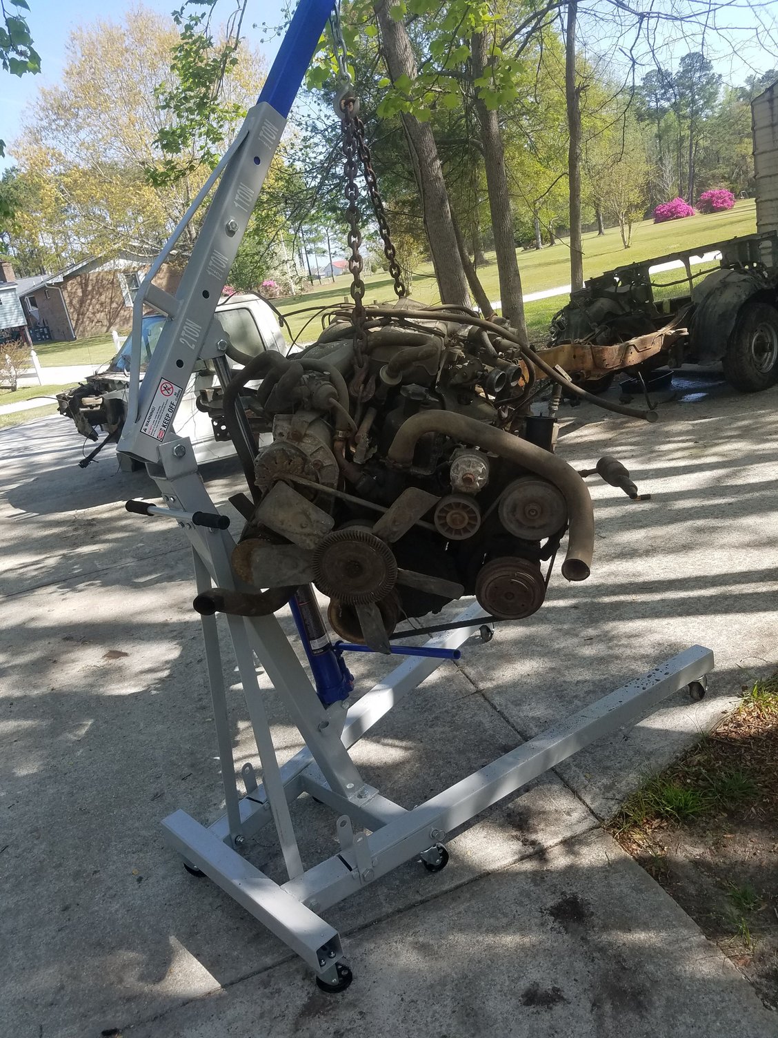

Figured I'd post up a little more of my progress.
engine stripped, degreased, and painted. Ready for the tweaks and to be put back together.
I've got the drop brackets installed on the 96 frame for the 4" lift, took some time to clean up and paint the coils.
Hope to have that buttoned up over the weekend and pull the rear end out to lock it, and install the rear lift springs.

So then I bolted the engine in the frame so I could get the transmission cross member moves to where it needed to befor the C6.
Then got the VB out of the C6 and a transgo kit in it.

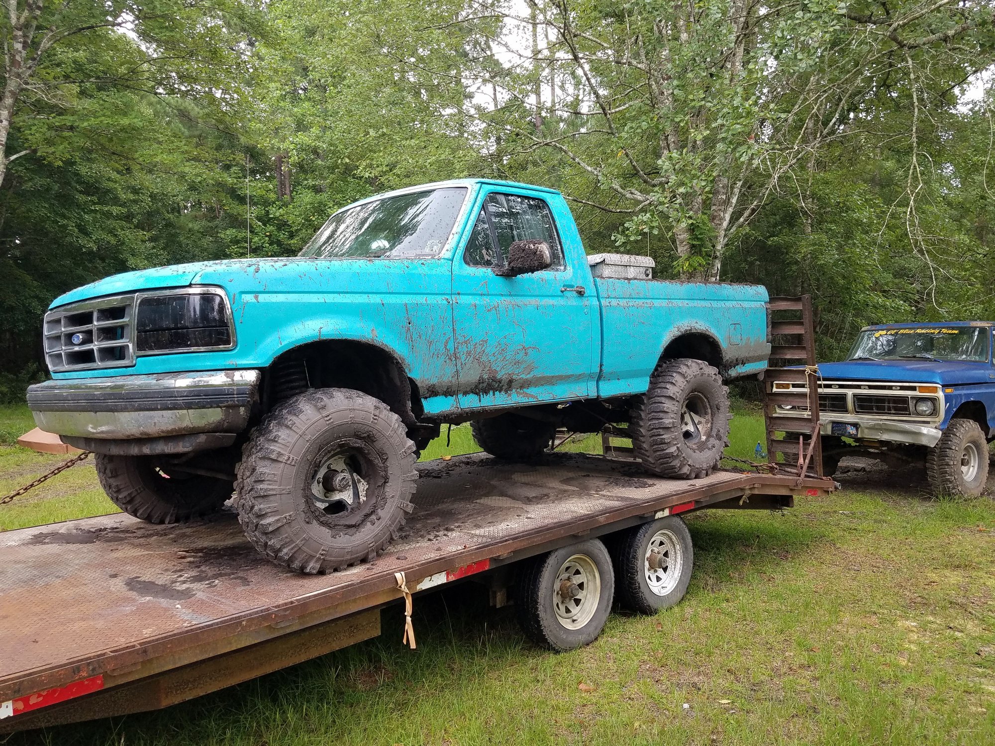

Not sure if it'll get fired up this weekend or not but it's really close. Should be at the August 12 race aslong as nothing goes wrong..
here are some updated pics.
I ended up doing a SAS in the truck so it is now setting on a 9" and solid dana 44.

Well the truck made it's first mud bog, 4 passes and loaded on its own.
