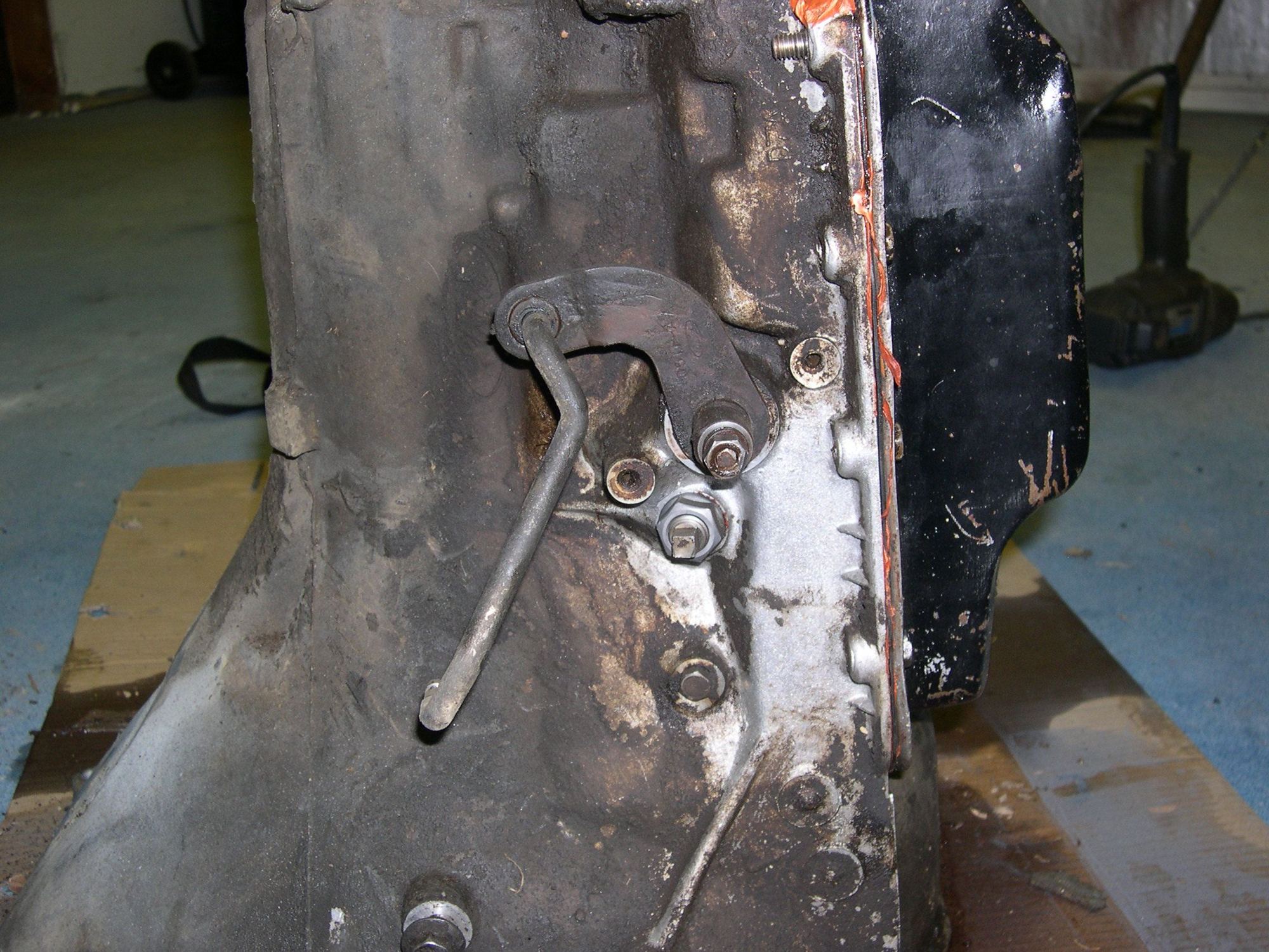

I'm not that familiar with the C6, but I think there is one on the driver's side of the trans, towards the front, just above the pan. Each tap will have a 1/8" pipe plug in it from the factory.

Hex headed bolt below linkage.
