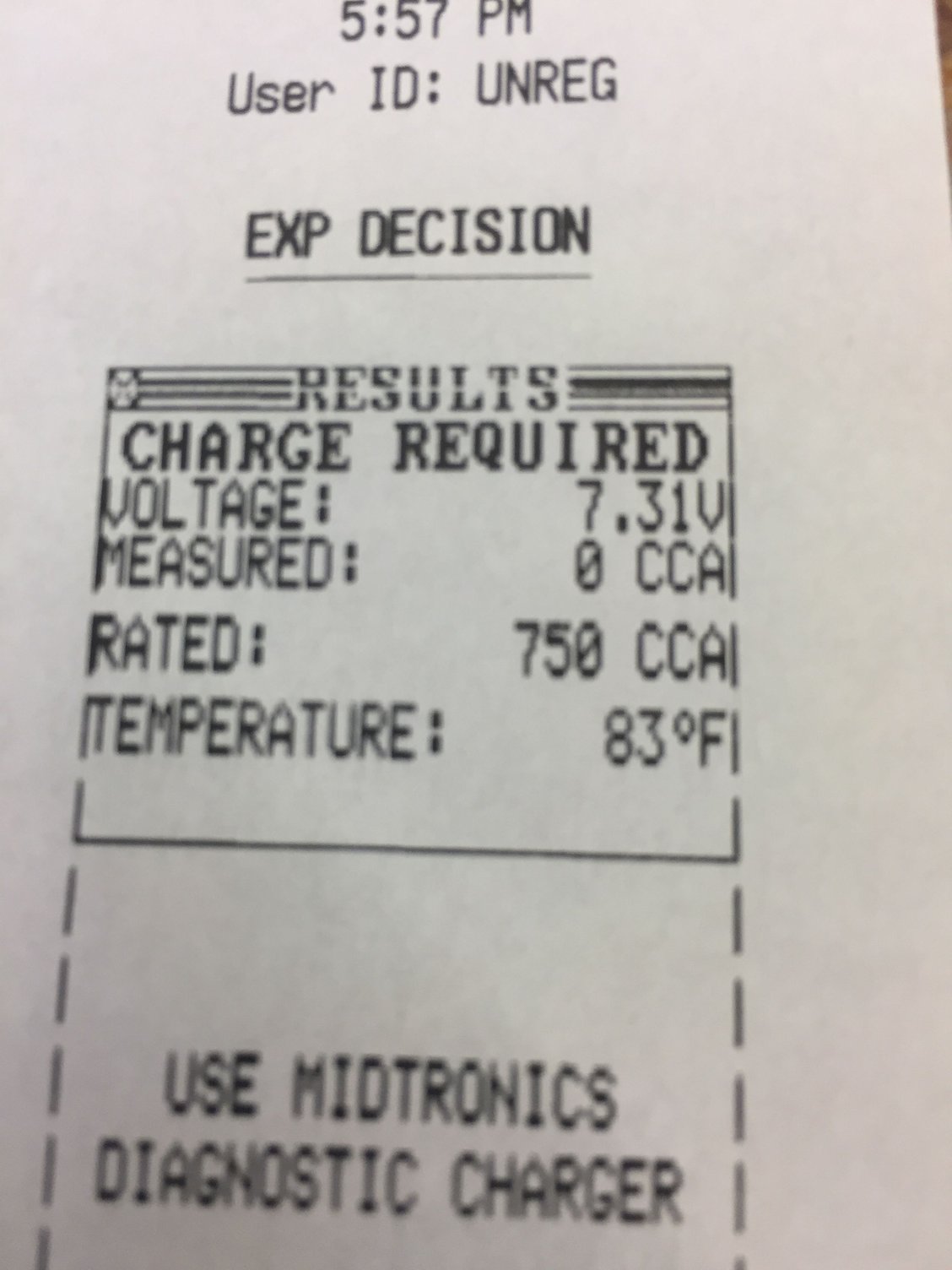

ok so I took out the battery's and one of them must of shorted out internally it only tested at 7.31 volts and zero CCA! Moral of the story is buy decent batteries not parts store house brands
It can happen with name brand batteries too. You didn't do anything wrong, it's just bad luck.
