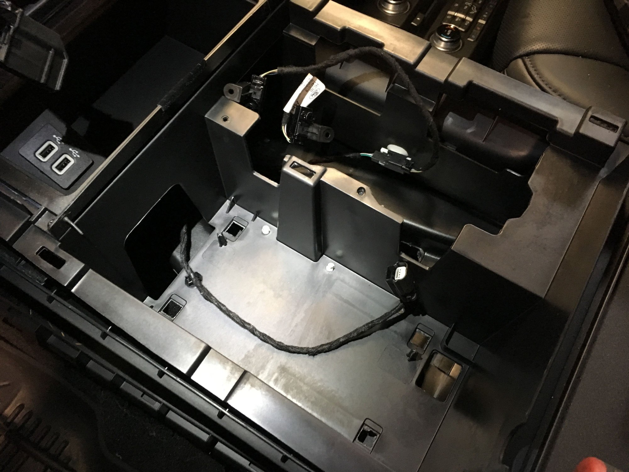

I decided now is as good a time as any to do. There is not anything of mention under the console. I think my rattle is sourced from the panels attaching to one another. In one of the photos from the under side you can see fasteners around the perimeter. I am going to undo, add friction tape, cross fingers, etc. I am also taking the opportunity to fix the sticky media door if possible. I am guessing a trim would be required. I also removed and re-attached the camera input at rear of head unit, per another thread about poor resolution.
Nobody is home.
Key transmitter/receiver
This assembly fastened to upper visual piece. Source of noise? Will find out.

I finished looking into the squeak/clicking/rattle noise. The manner in which the console is assembled is likely the cause. The aluminium bits you see in first photo are two separate pieces tightly pressed together, they have direct contact with each other. Think back to the day when you installed an aftermarket speaker, the grill had metal tabs you would bend to secure to speaker. There are about 6-8 of these tabs, other areas are glue bonded, and the metal itself is formed and bent around the plastic chassis.
With the console out as I would flex it you could reproduce the creaks and squeaks easily felt at the metal contact areas. I added extra adhesive to various sections. I will not know if anything I have done will make a difference until I drive it, probably not until this weekend. I think the most important change I made was to insulate the upper console with rubber orings at all contact areas with the base of console. This in practice anyway may lesson vibrations entering the console.
Media door fixed, closes correctly. I added a piece of soda bottle to the piece in photos. I understand, under warranty, however I will not let someone tear my dash apart. I trust myself and staff only.
Forgot to mention, fiddling with the camera connection at rear of head unit made no difference for me. Images still grainy and horrible.
Diet soda bottle...hard to see but it is in there.Shiny stuff is mineral oil, it made no difference.
