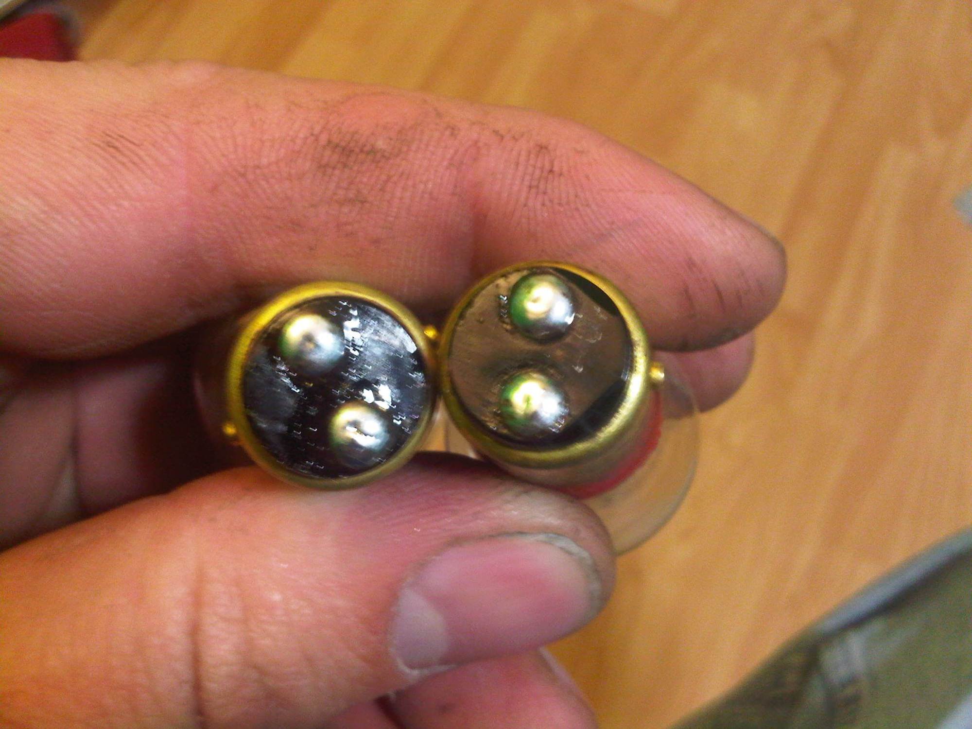

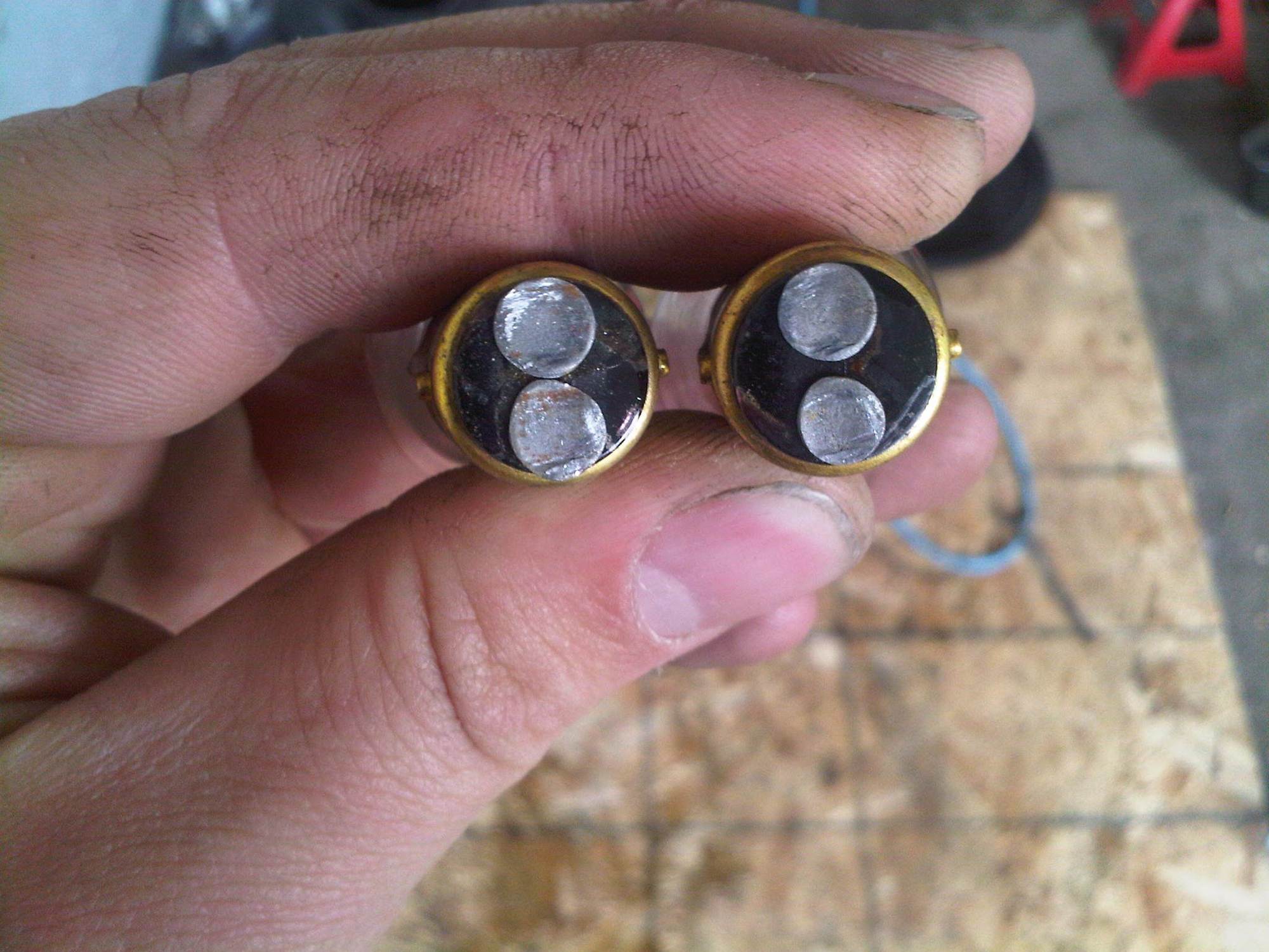

Check your turn signal bulbs, I had one side do weird stuff and the contacts on the bulbs had soften and contacted each other.
