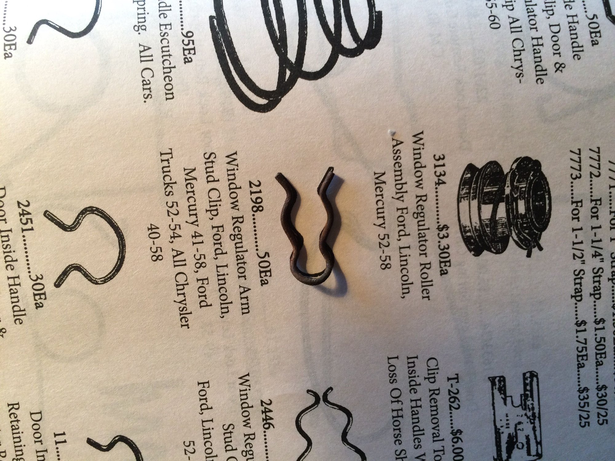

Here's my spare when I get desperate
Thing of beauty

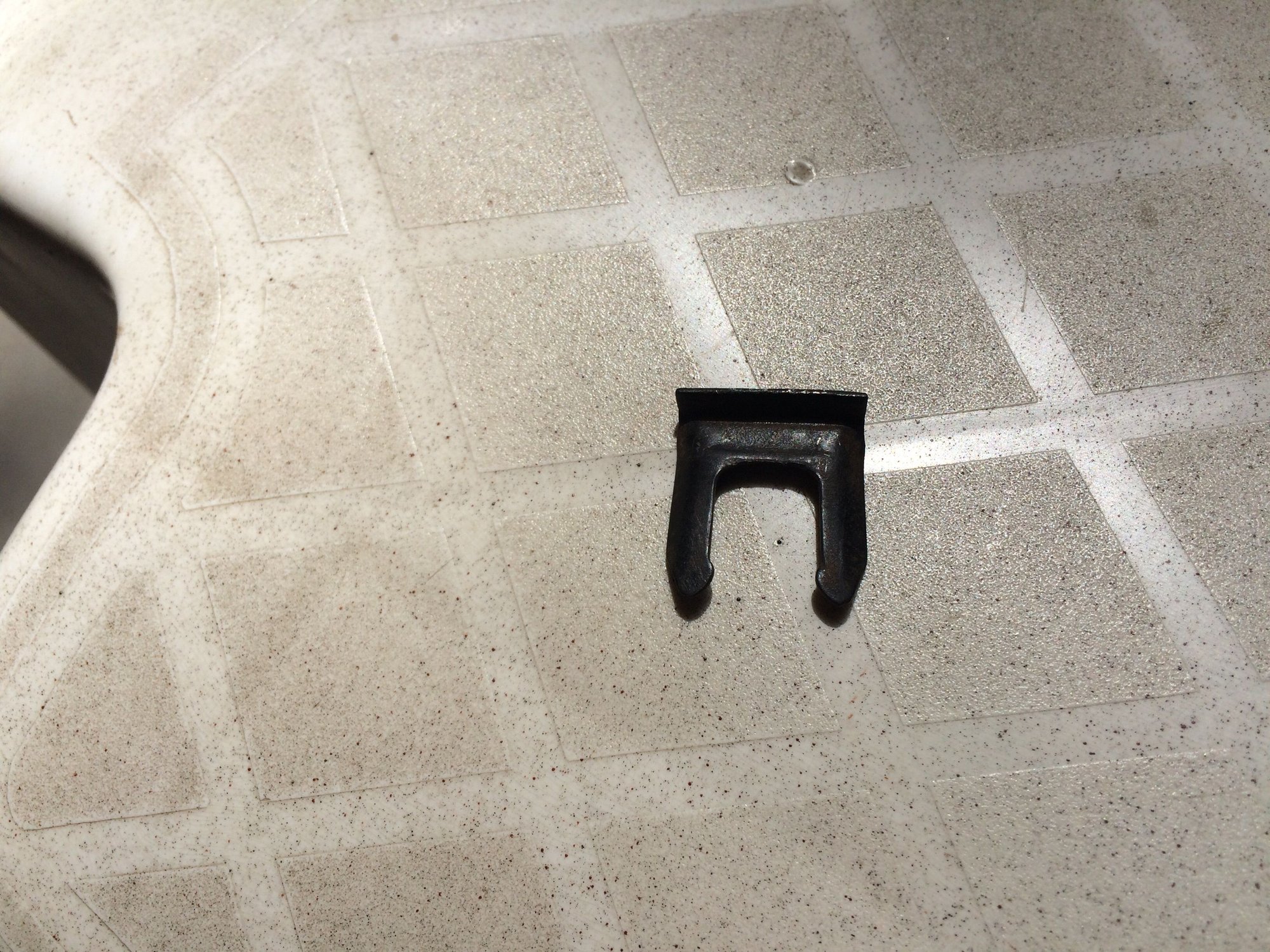

I'm sorry had that on my #4 door and I'm still short one may try one of these
A clip for brake line

Found them Restoration Specialties cat page 179
Part # 2198
Roy, PM me. I think that I have an extra brake line clip. Give me the ID just to make sure.
Sorry I have confused you I don't need brake clips but thank you

Originally Posted by ALBUQ F-1
I wonder why they are listed for '52-'54 only?
I do not have a 1944/52 Car/Truck Body Parts Catalog, so these applications are 1953 and later.
357550-S .. Inside Window Crank and Door Handle Retainer / Obsolete
These standard (aka hardware) part numbers are listed in truck & car parts catalogs under the 22600 door handles and 23342 window handles.
Applications: 1953/56 trucks / 1953/59 Ford Passenger Cars / 1955/60 Thunderbird.
NOS PARTS LTD in Waxahachie TX has 2 = 972-937-2201.
GREEN SALES CO. in Cincinnati OH has 11 = 800-543-4959.
I have no idea if the clip I posted is correct or not it was on 2 window regulators on my 49's and I don't know which one
I don't think this is stock
Post #12: 357550-S matches #2451 in your post 6 pic. Since I don't have a 1944/52 body parts catalog, I don't know if this is the correct clip.
This exact same clip was used on 1940/50's GM cars.
I still have the GM tool used to remove them (looks sorta like pliers), but it's designed to slip between the door panel and handle, then it's turned, causing the clip to fall out.
Call Green Sales (800-543-4959) and ask them for the clip part number for 1948/52 trucks. I wouldn't be surprised if it's 357550-S
