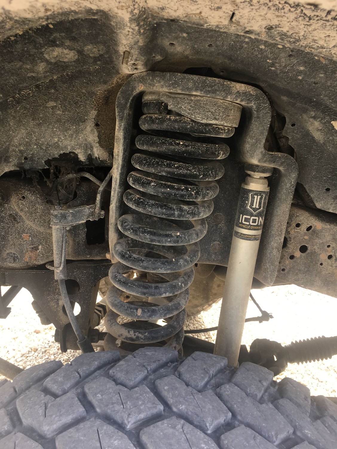

Hey guys. So I noticed the other day that my front axle is tilted forward a little bit. Would this cause any problems or will it be alright.? If it's going to cause problems, how can I fix it.? Any advice is appreciated.
i can also take a few pictures if you guys would like.

It is a 2006 F-250 4x4. These are the best pictures I have for now. I will take better ones after I get off work. And I'm not sure if the spring is bent because of the axle but it looked like it would be so I took a picture of it too. I did my best to hold my phone level when I took the picture to give you an idea of how titled it is.

Sure looks like to me like something is going on there. Also appears that cross member behind the drag link is bent.
It's tilted, that much is true
U bolts coming loose?

Looks like the truck is lifted. How much of a lift is on it? I see an adjustable trac bar as well. Did they use radius arm drop brackets?

It has a 7" lift on it. All the bars up front have been upgraded and have put drop brackets on what I could so far besides the radius arms.

That adjustable track bar appears bent.

The track bars aren't straight to begin with.

So no drop brackets on the radius arms?
I don't see anything wrong with the truck. Does it drive normally? Nothing is rubbing. That much taller of a spring is going to look like that.

No drop brackets on the radius arms but I am hoping to buy them soon. And yes, everything drives fine and there's no rubbing as far as I can hear and see that there's no bare metal anywhere. I was only curious about the springs because I had a 6" lift before and the springs were straight.

I'm no expert on lifts or coil sprung SD'so bear with me if this makes it obvious I don't own one. This looks like a simple geometry issue. Think of the radius arm like a leg of a triangle, the spring is another leg, and the horizontal distance from rear of arm to spring is the last leg and the only constant. The spring leg grew by 7". If those arms are stock, they are both rotating the diff by change of angle and bending the springs because the "leg" is now too short to keep the spring leg at the original angle relative to horizontal. That's why drop brackets or replacement arms are in the kits.

Thats what I was thinking myself actually. I'll have to look under it tomorrow when it's light outside. I didn't put the kit on myself so I don't know if the radius arms have the drop brackets on them. I wasn't aware they came with the kit, but I just looked and the kit I bought did have them. So to contradict what I've been saying, the truck should have them on. I'll just have to check for myself to make sure.
