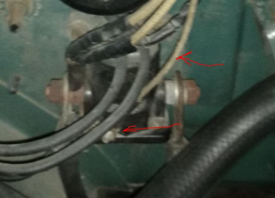

Originally Posted by abe
Both the terminals on my solenoid are the same size. One gets the hot cable from the batter, the other goes to the starter.
I think I'm taking my remote starter back to Advance Auto...
I agree with Ray that it's not particularly useful for setting crank position for valve adjustment. But your solenoid has 3 terminals, you can see the small one down below the big ones in your picture (lower arrow) and the wire going to it (upper arrow)

Your right , Ross! It was hiding behind the wires. Thanks.
