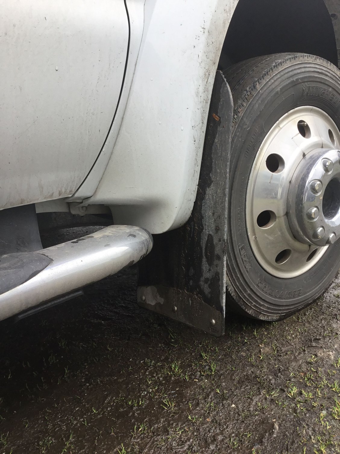

Thanks Cooper.farm for posting the pic's.
thats kind of the coverage I'm looking for.
Low and wide.

The front ones are specific for the 2008-2010 F450, the rears are normal Ford dually. Mounting the front ones requires great patience and long needle nose pliers or the smallest vise grips you can find to hold their T bracket. They do a great job of keeping the sides of the truck clean.

so I was going to return the gator mud flaps, but the reseller who sold them to me sent me a return label that said 50% restock fee if there is writing on the packaging and since they did not wrap the box, UPS wrote all over it. so rather than fight the 50% restock battle...decided to make some brackets and make these gator flaps work.
I used 1/16th of an inch diamon plate about 12" X 18" in size.
in the front, the plate went vertical hitting 2 edge body holes on one side and bolting to the frame crease on the other.
in the rear, the plate went hroizontal hitting the dullay egde holes, the oritginal srw body edge holes in the middle, and the corner of the flap was bolted to the inside corner of the diamond plate on the top, and on the bottom, using the oem bracket.
heres some pics.
