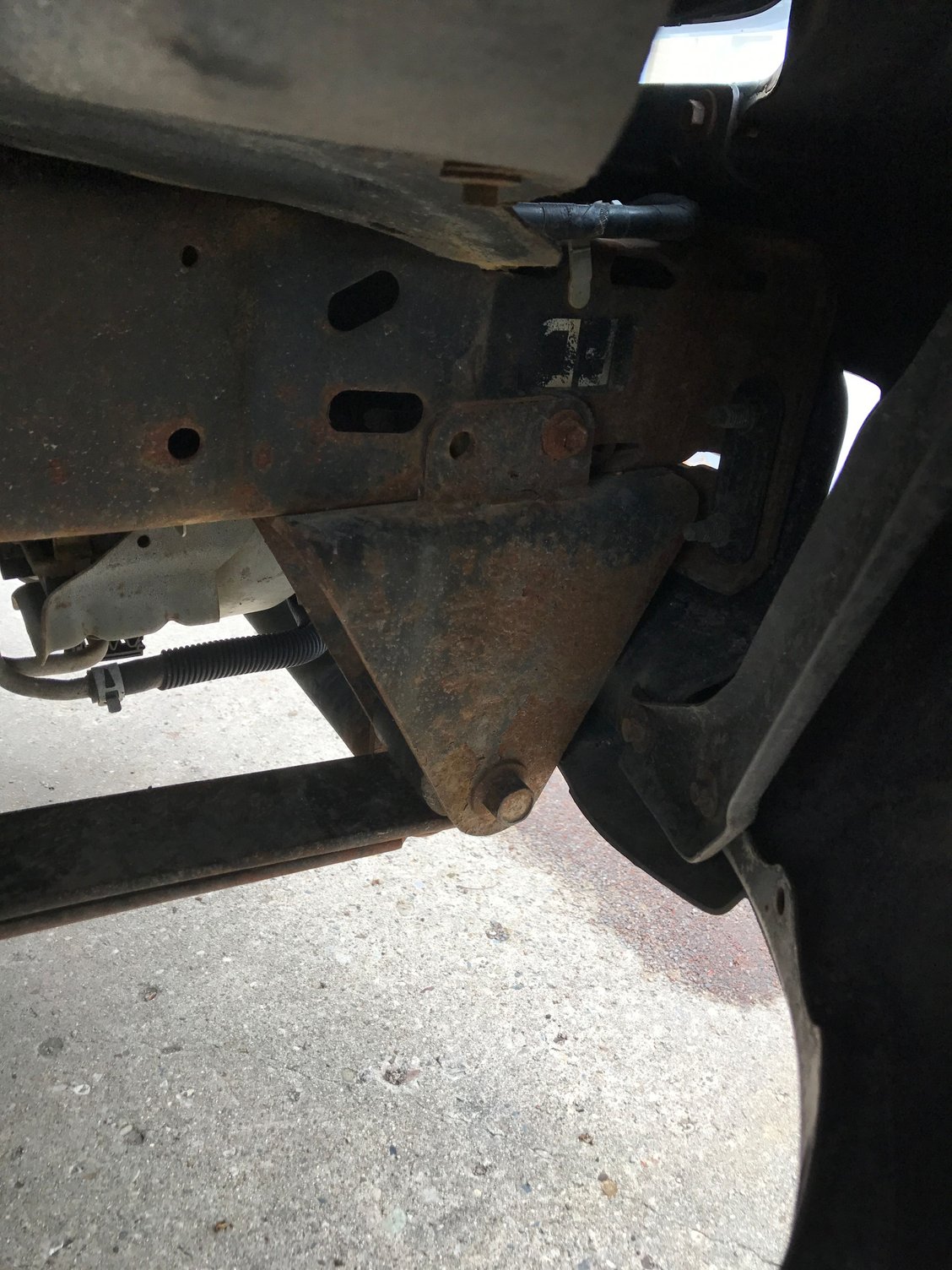

Just wondering if anyone can take a look at my suspension and let me know what I have going on. Can't tell if it's a leveling kit or lift kit or what. I'm sitting on 315s right now but they rub in the front when I turn so I'm wondering if I should go down to 285s and pull the lift or leave the lift and use the 285s anyway or just leave it all. All help would be great.

Tall rear blocks and no front leveling pack - just a FabTech dual stabilizer in the picture. Is there a shackle lift or box lift on the front spring? The rub on the front while turning is wheel offset, lift won't change that much.

Take a picture of the front mount for the front leaf spring, take the picture from the side of the truck to show spring and mount to frame.

Here's the pics of the shackles. Not sure if they are stock or not.

The front mount of the front spring is not stock, dropped by at least 4 inches. That shackle mount does not look stock, though I do not have a truck in the driveway to look at today.

Pulling off the lift would be a significant undertaking, especially if you did not have the OEM components:
- track bar length and mount
- shocks
- brake lines
- front axle leaf spring mount at front and the rear for the shackle
- rear axle blocks and new u-bolts to tie axle to spring
- pitnum arm length
- sway bar connecting link lengths
- carrier bearing angle/shims
A different set of wheels with adjusted offset might be a lot more affordable, or move down from 325 to 285, or just drive it as is.

Well it's not rubbing on the leaf springs when turned it rubs on the cab from the back right corner of the tire when turning right. So far it has rubbed a hole in my cab.

Sorry not my cab but my inner fender piece.

From the pics, are you missing a bolt holding the front shackle on. I see a hole, but no bolt and there is one right next to it?
