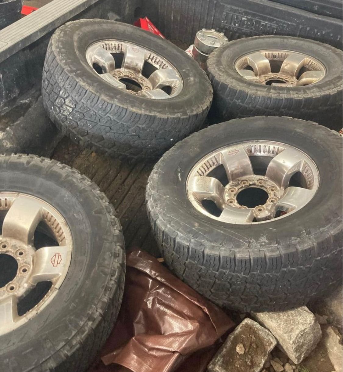

HOLY MOLY —Needle found!!
Originally Posted by tbwonder
WOW….that’s a needle in a haystack! All those years they only offere an upsized wheel in that one year and model set?
amazing.
will start watching for them or them aftermarket I guess if I feel I need.
Going to do the springs in the next week or so and get that situated and then see how it sits…and weigh against my possibly gear change too.
Thanks for always commenting and answering ?’s👍🏻
I can’t believe I’m saying this but I just found the needle in the haystack… Just picked up this set of four 2004 wheels Harley Davidson edition… Need some refinishing $500 for the set with (non Harley) caps!!!Meant to be!!👍🏻👍🏻
what size tires are on your 18’s?
