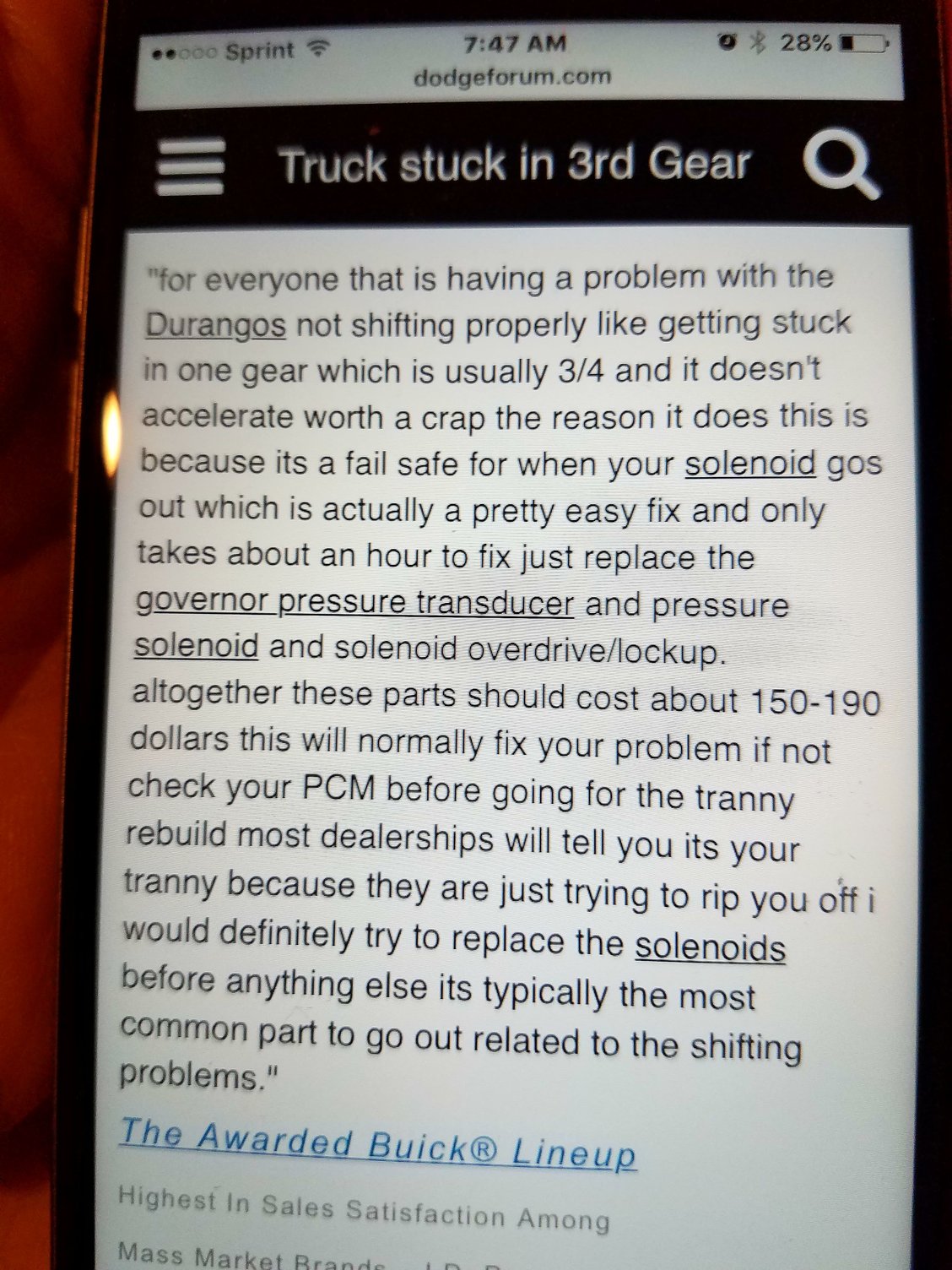

I remember Jake seemed to think it was something electronic or a bad solenoid. It started doing it suddenly in the dead cold of winter.

I just found the picture he sent me of some info he found on the Dodge Forum...
I guess I should look into it...
