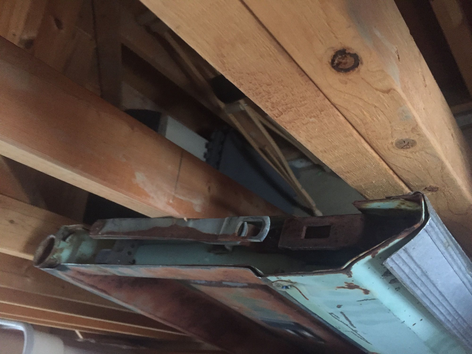

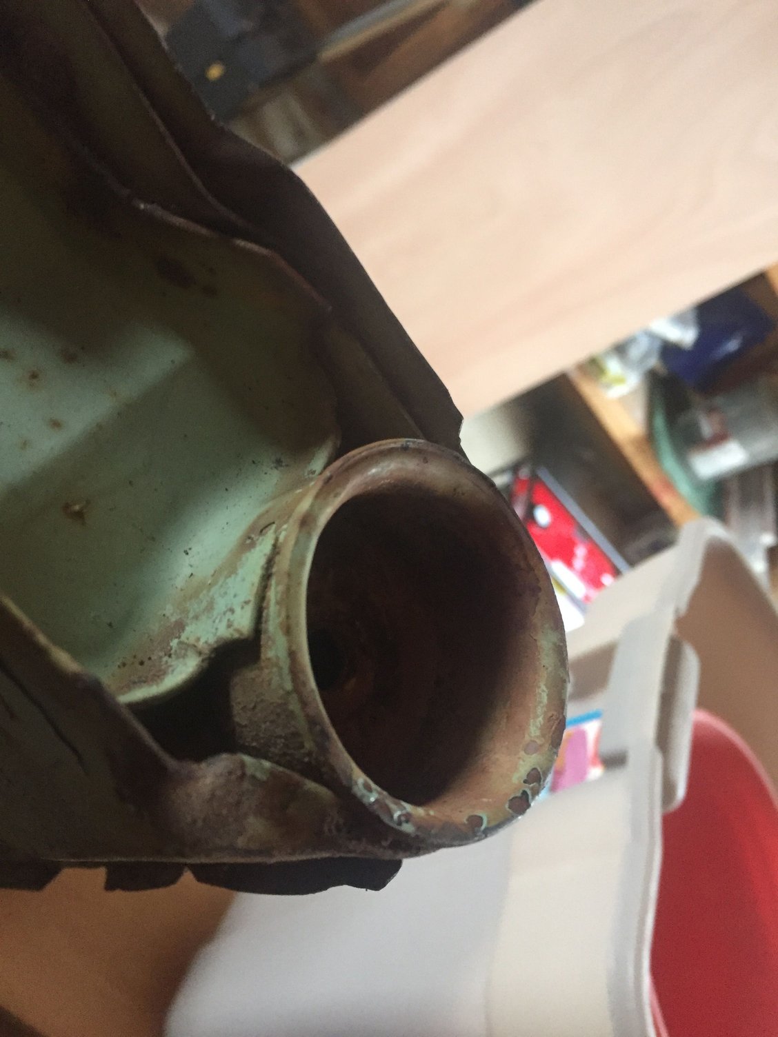

The gnarliest part is the bushing housing shown in the picture. Also, I don't have one but you can reuse the old. Otherwise the tailgate is solid.
