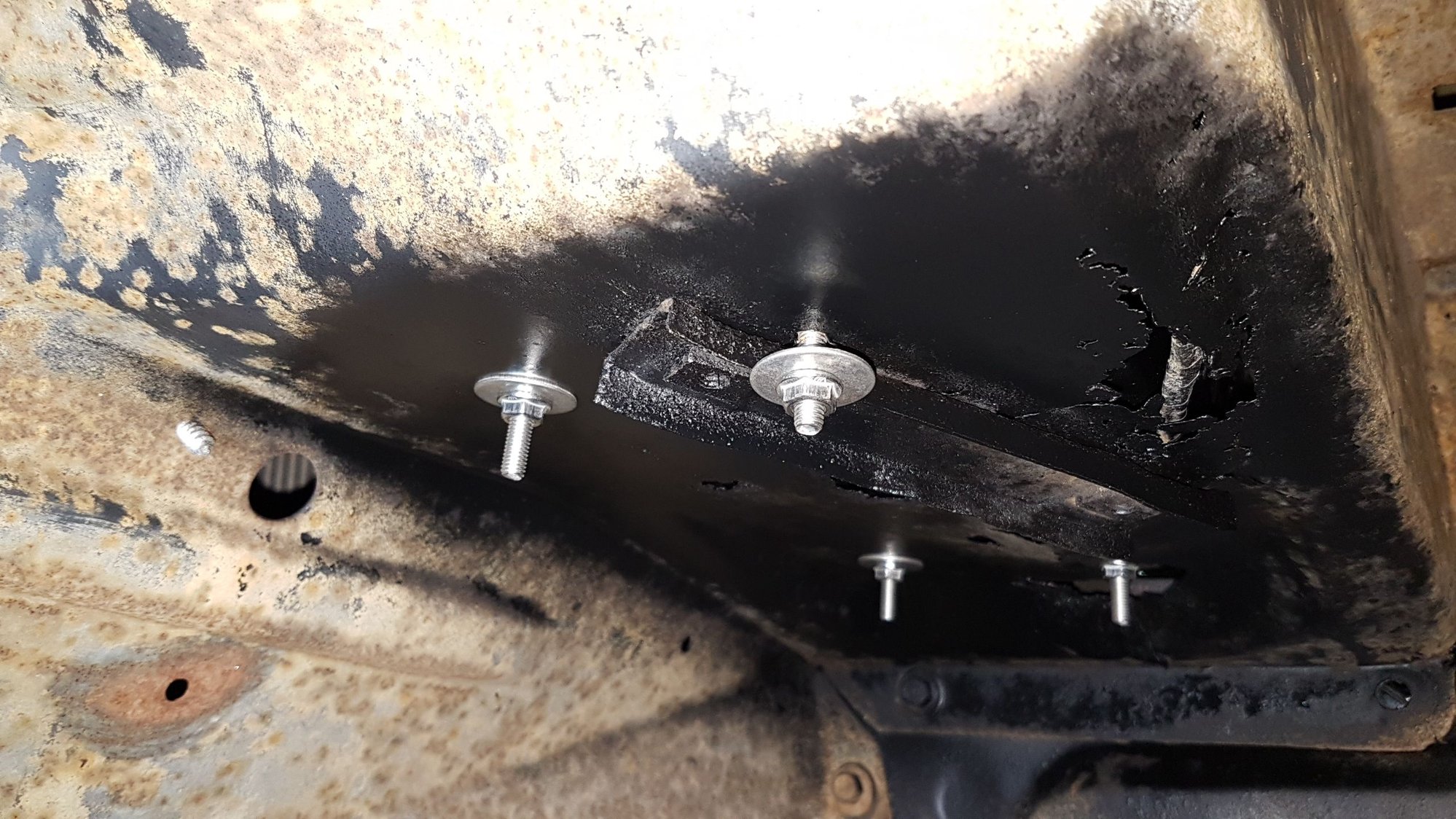

Hi. I have a 70 f250 and the area under the battery tray had corroded. There is a new battery tray in place but the inner fender needs repairing. Is there a patch panel available for this? I live in the UK so don't really want to ship an entire inner fender.

Can't find anything in their catalogues so have sent emails. Area of corrosion under battery tray. Sprayed with metal protect .

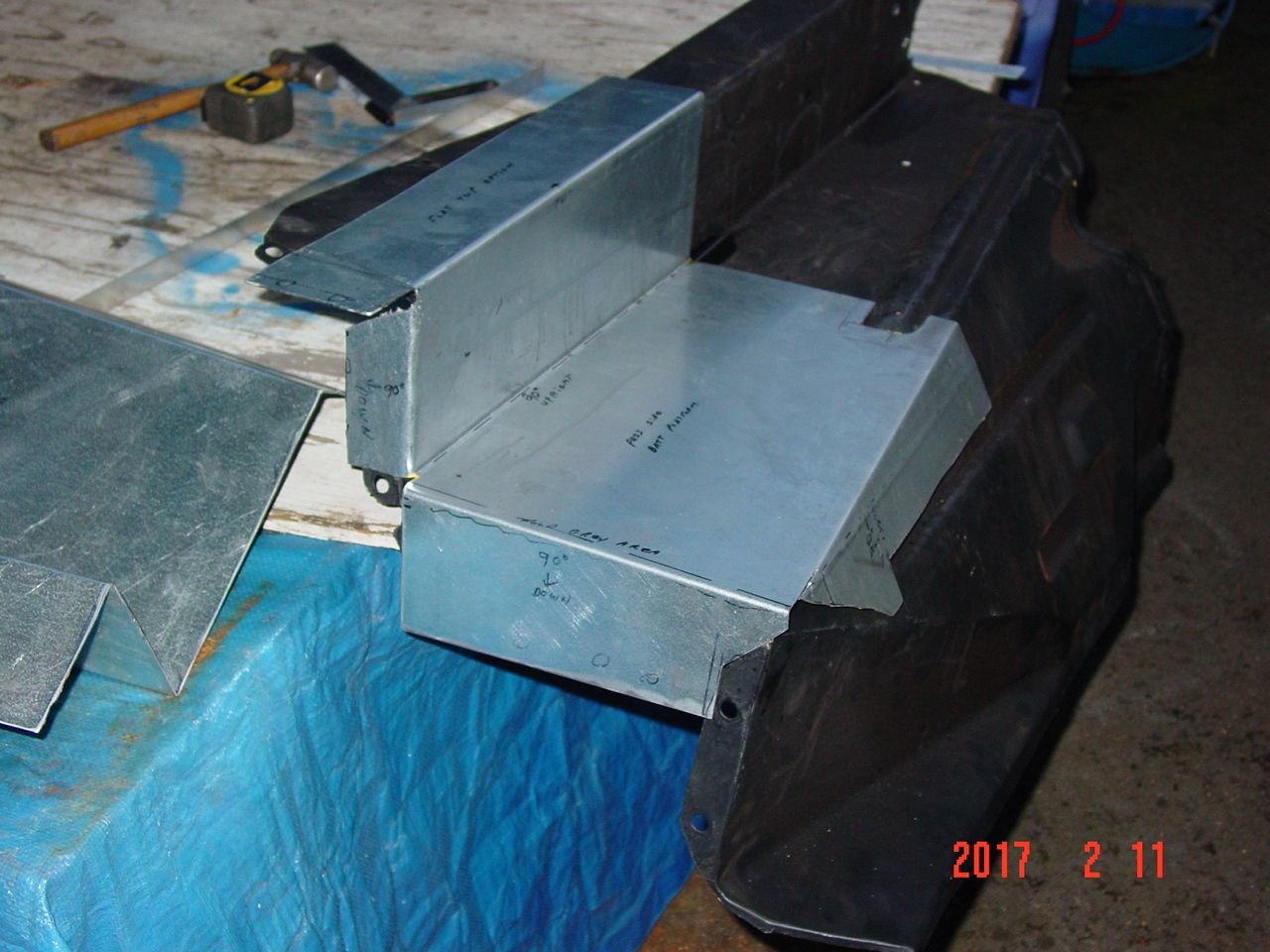

Probably be just as easy to make and weld in a patch for that. Looks to be just a flat patch for it.

They make the upper portion, where the hood hinge mounts. Nothing for battery try that I know. My first truck I just made my own patch. Nothing fancy since it is under the battery.

Bump side stuff is hard to find but dentside stuff is still around. I used a dentside inner as a donor for a patch. Was pretty close and ended up looking good. Hope this helps.

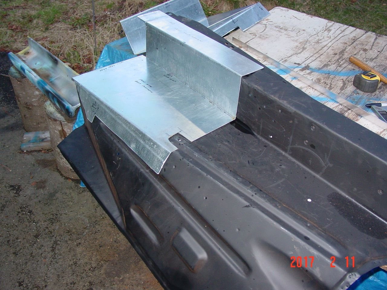

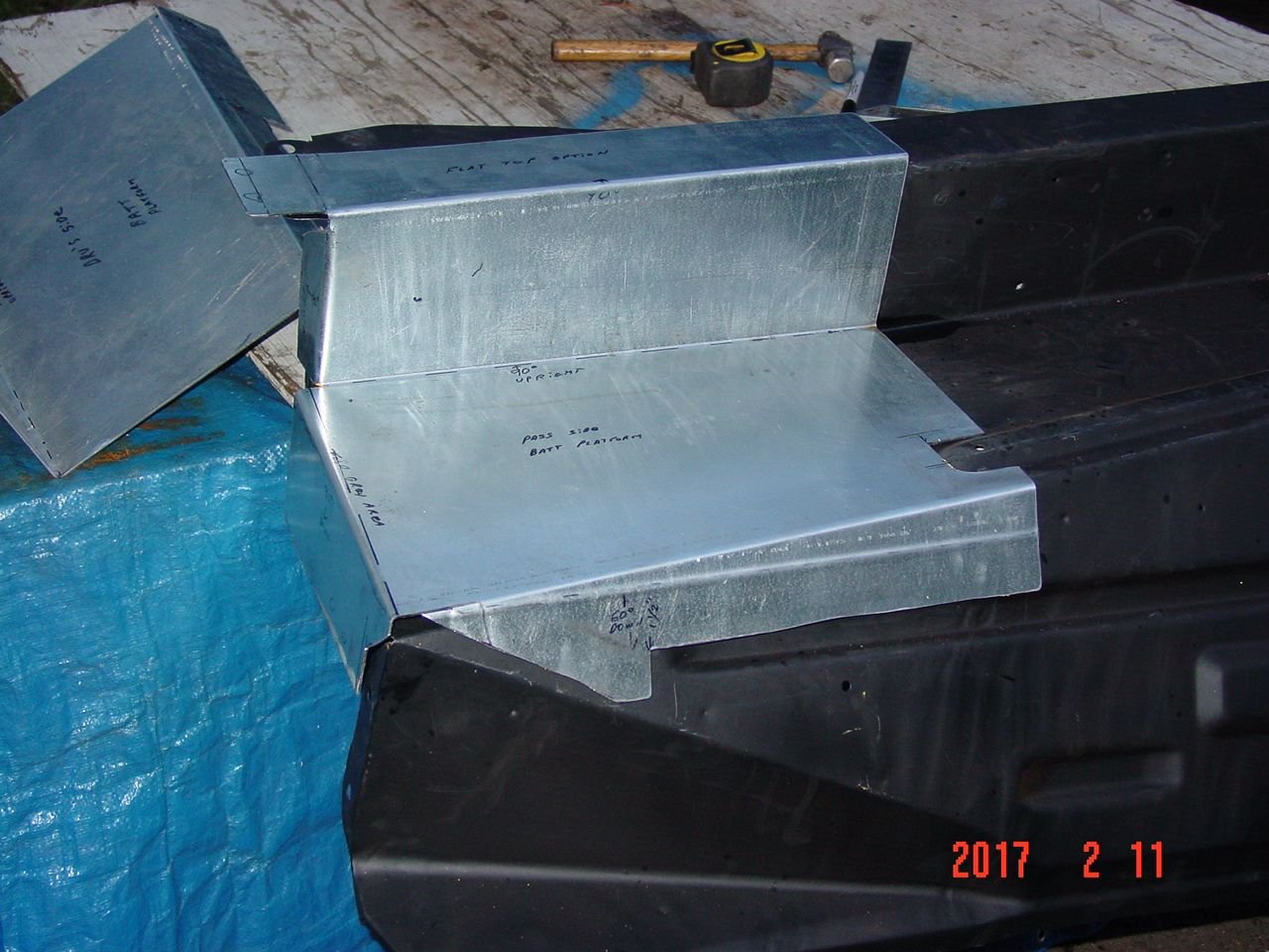

I made my own patch. I can get the measurements if you need them.

Very Nice Gary!

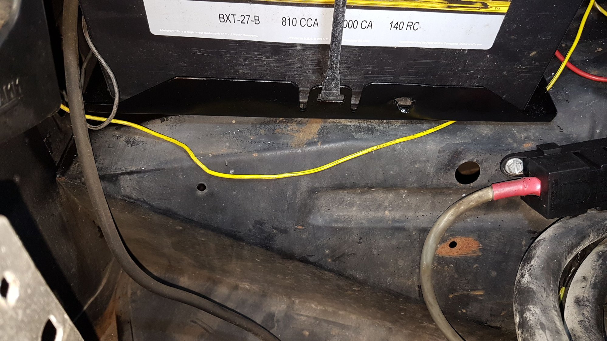

Hi thanks for the reply. The battery area on my truck has a slightly raised bit so that that the battery can sit level due to the inner fender sloping slightly down towards the front of the vehicle. I tried to take some pictures today but I had already put the battery back on so took from underneath. Bit difficult to see raised bit of inner fender.
You can see the battery tray is level but the inner fender slopes.

The patch that Gary made would work fine (and nice work on that patch, BTW!). That would probably be the way to go. It won't look exact, but, unless you're doing a concourse restoration, this should take care of it!

I was more worried about the battery not sitting level than the look of the panel that needs replacing.

I think a patch like Gary's would be perfect. You might even be able to use a smaller version of it also.
