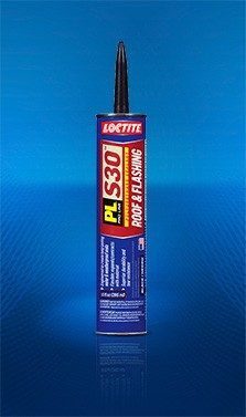

This is the best rubberized sealant. I use it on solar mount flashings, bonds well and dries flexible like the rubber on a tire. Black is the only color. Cut the nozzle thin to work the sealant into the gap, and smooth with a rag.
