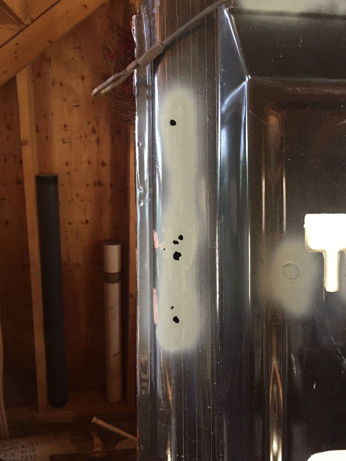

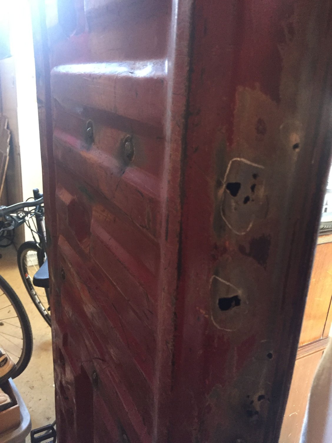

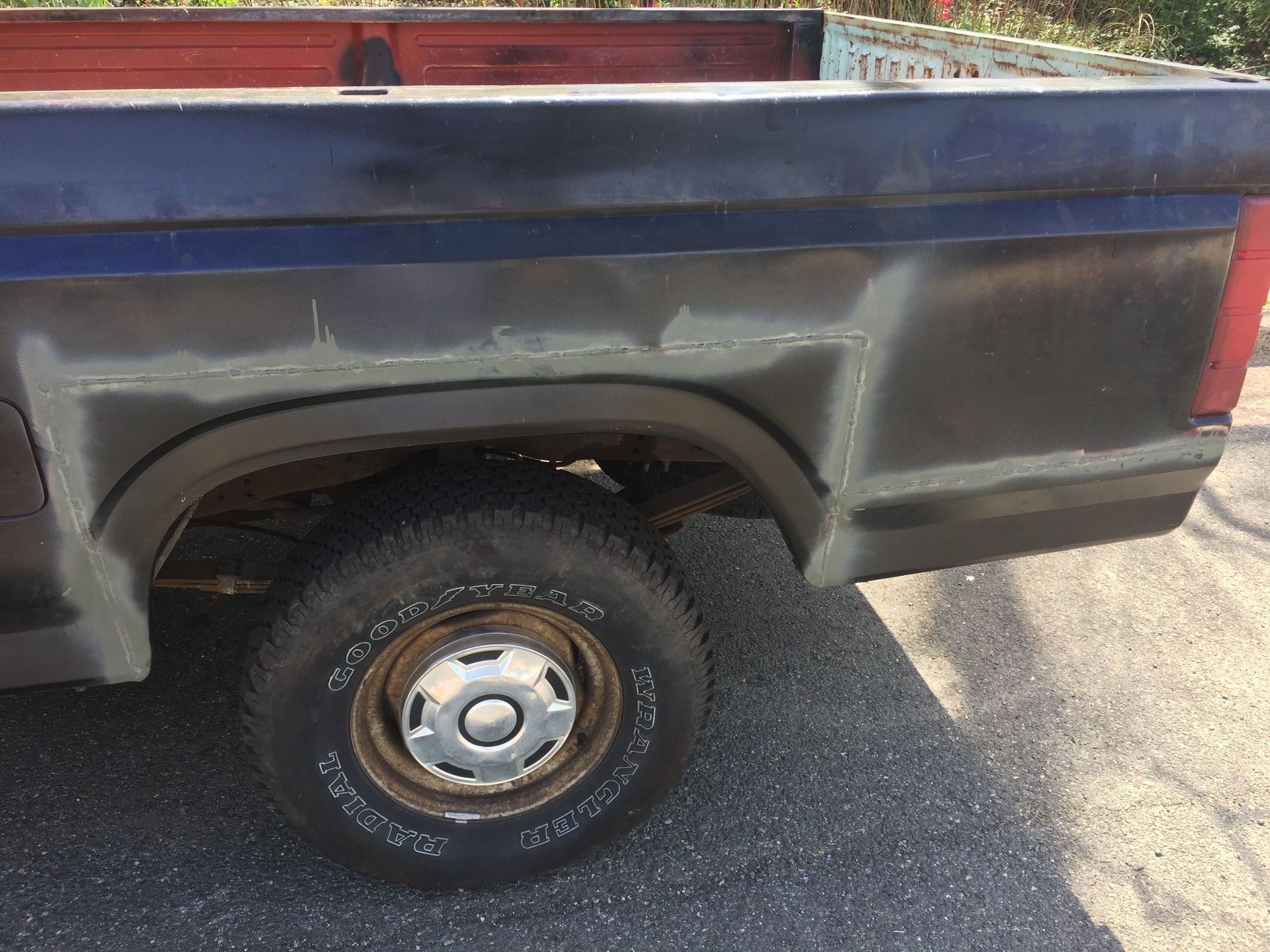

Results are in. Any advice on grinding down the welds? Also, How can I fill these holes in the tailgate? Cuz said mig w/.3 wire is a no-go. ?
Any way to fix the bent front rail of the bed?
How can I fill these?

For the front rail you can either replace the whole front panel, or I think I would find some 1/8" wall square tubing that is close, cut the old top out and weld the new tubing in place.
For the other holes, you are going to have to cut it out and weld a patch in place. Get some flat metal. For the bottom of the tailgate you could cut a large rectangle piece out, cut a new rectangle piece and weld it in place.
If you try to weld the rust holes shut you end up with a huge hole instead, the metal is so thin and rusted around those holes you can't hardly weld it.

Ok. The piece on the tailgate--how will that be joined? a butt joint?
Do it just like you did the bedsides over the wheels.

Front rail not seeing it in person its hard to say but I think I would try and pull the panel back into shape.
Back the truck up to a tree or power pole to pull from and use a come-a-long to pull it back.
I have a stud welder for pulling dents so once back in place I would use then to pull the dents. If done right you would only need a skim coat of filler if any.
Yes on the rest, cut the rust and weld in patches.
For grinding the welds. I use a stone on my 4" grinder to take down most of the welds but still leave it high.
KEEP MOVING so you do not warp the panel.
To take the weld down more I then switch to a flap wheel on the grinder.
I would use a 40 grit flap to take it down farther but again not all the way then switch to a 80 grit flap down to finish level
Did I say KEEP MOVING! If not KEEP MOVING!
You don't want to warp the panels.
If all turns out right a skim coat of filler and should be done. May need to tap down any high spots but that is normal.
