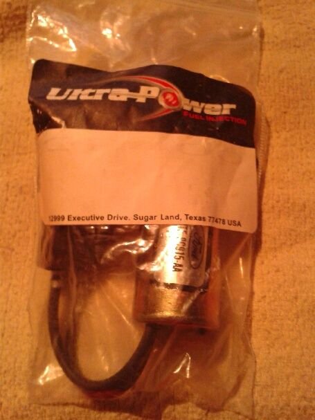

Follow up:
Alright, as it turns out, Ultra-Power PN: CP400 looks a LOT like Ford PN: E3TE-9C915-AA ...and is even marked as such with a Ford logo & all.
So I think it's pretty safe to say that when you buy an Ultra-Power CP400, you're actually getting a NOS FoMoCo E3TE-9C915-AA, however that helps me very little since this is NOT the correct part.
Yes, it looks just right in the illustrated catalogs, but it is the wrong size for the vent hose, and is listed for applications with smaller engines.
The plug connection is correct however, and the original plug appears marked (as best as I could tell) as PN: D3AB-4A459-FB, and the "Ultra-Power" connector is marked in two places: One side is marked as "13 H" (the one is hard to see, but it's there), and a broad side is marked with 14A459. The plug connection may or may not be available through Ultra-Power in Sugar Land, Tx, but I un-pinned this one to use on my old part when I went totally OCD on it.
After a thorough soapy scrubbing and then an alcohol bath, I used JB Weld to reconnect the broken piece of the hose connection, and decided to wire-wheel the metric ton of crusty motor oil off of the metal case before shooting a couple of coats of rattle-can clear on it in hopes that it'll never ever corrode. I rehydrated the rubber grommet using peanut butter (yes, peanut butter, an old-timer showed me that trick) - I've heard you can use vegetable and mineral oil as well, but never tried it for myself. I cleaned the wires using WD-40, and soaked the terminals in coke before steel-woolling them perfectly clean. As I mentioned before I used the plug from the new part to complete the refurb, and I'll be attaching it to new hose once my carb comes in (it was puking fuel through the vent which is why at first I thought it was a return line - duh), and hopefully I can get another 30 years or so out of it since it seems to be a genuine pain to acquire. I just wanted to share, and hopefully keep the record correct. Thank you for all the replies, Cotton

Originally Posted by CottonTexas
Alright, as it turns out, Ultra-Power PN: CP400 looks a LOT like Ford ID engineering number: E3TE-9C915-AA
No Ford part numbers marked on parts after 1956, just casting or ID engineering numbers, when applicable.
E3TZ-9C915-A .. Fuel Vapor Storage Canister Purge Valve (Motorcraft CX-792) / Marked: E3TE-9C915-AA / Obsolete ~ 100+ available NOS

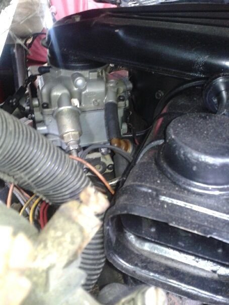

This past weekend, I looked at the engine in my son's 1984 F150 with 4.9L engine. The part [in your photo, above] with the smaller diameter fittings would fit near the PCV valve. The piece with the larger diameter fittings was between the carburetor vent and the charcoal canister.
Old Apr 3, 2017 | 05:55 PM
CottonTexas's Avatar
CottonTexas
Joined: Mar 2017
Posts: 61

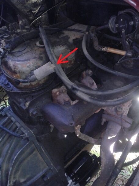

Thank you for your input. I snapped some quick pics of my engine the other day, and it would appear that there is a jiggy-mə-bobb that would likely be PN: E4AZ-9C915-A at the PCV valve at the rear of the valve cover just as you say:
Aside from the plug being different, it looks nearly identical to the one that I bought for an '83 model, so I may try to hang on to it to re-pin later if I need to. Thanks for the reply 1986F150six
I snapped some quick pics of my engine the other day, and it would appear that there is a solenoid that would likely be PN: E4AZ-9C915-A at the PCV valve at the rear of the valve cover just as you say.
This is not a solenoid and the part number is for Econoline & misc. passenger cars only!
E4AZ-9C915-A .. Fuel Vapor Storage Canister PURGE VALVE / Marked: E4AF-AA (Motorcraft CX-907) = 1984/89 E150/350 I-6 & V8.
