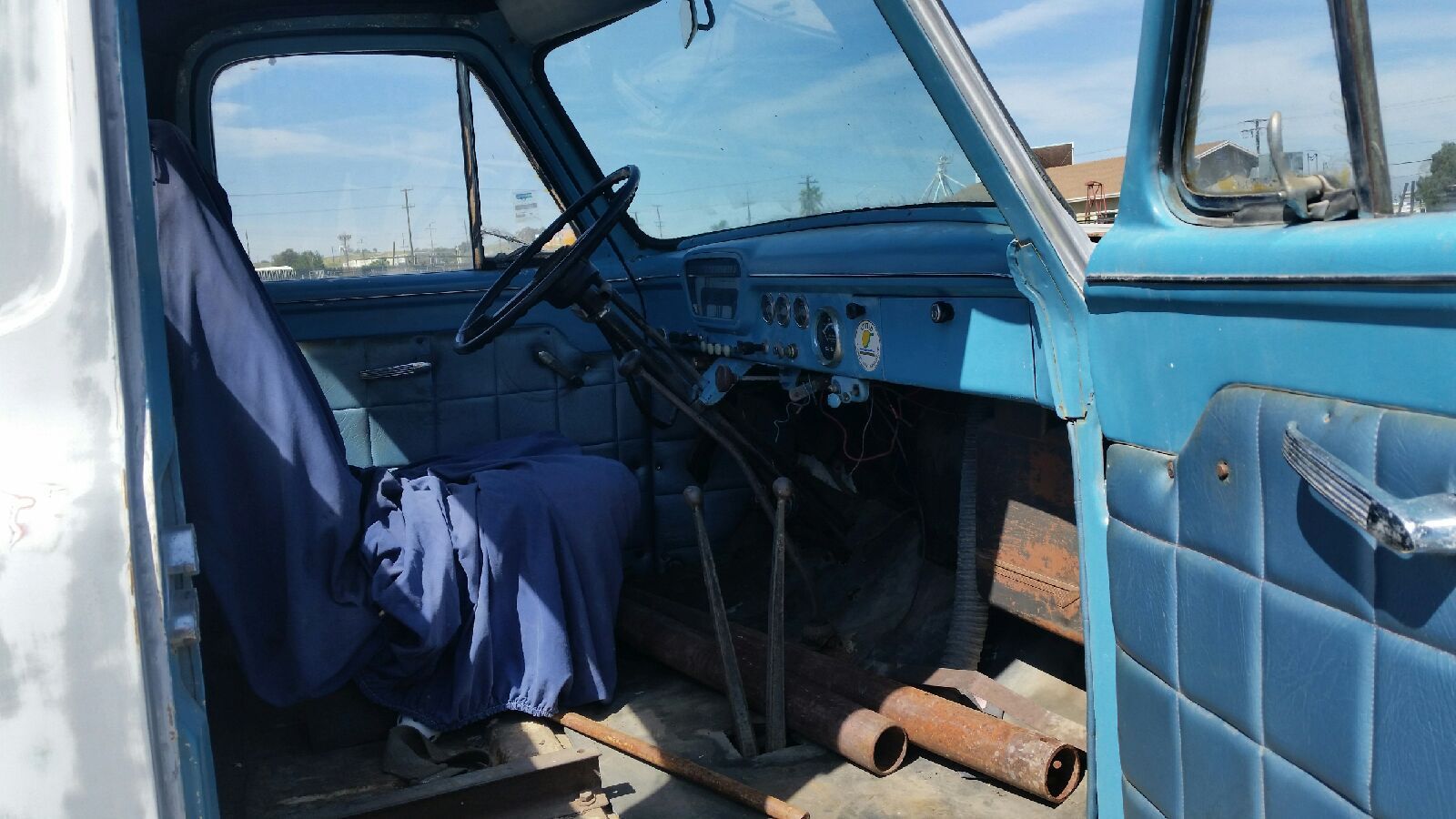

I passed up the 77 F600 4x4 I found the other day because I wanted more of a classic. I came across what is supposed to be a 1955 F350 with a 4x4 conversion done from the factory for the military, but by looking at the v.i.n. it looks like a F100; not a F350. It is also a short bed, and I have never known a F350 to be a short bed. I will post a couple photos with codes, and hopefully Bill or someone knowledgable will chime in to let me know if it's an authentic dealer 4x4 conversion, or if it's something someone stuck together. I love this bodystyle, and being rust free is a plus too... all input welcome. The story is it was purchased by the US Military from a dealership after the 4x4 conversion.

Looks like someone's project. The truck was originally a column-shift with overdrive. Definitely an F-100 originally. Every gov't services truck I've seen also has a brass Service Data plate on the dash.

This F100 came from the factory with optional 3 speed Overdrive and the standard equipment Spicer 44 rear axle w/4.09-1 ratio. I doubt either is still in place.
IMO, this truck had nothing to do with the US Gov't. While the Gov't would buy F100's, they wouldn't come with 3 speed Overdrive, would either have a 3 speed (no O/D) or 4 speed.
Trucks sold to the US Gov't would have 83 stamped on the Rating Plate and if a 4WD conversion, would have 4 additional numbers after 83 denoting a Domestic Special Order.
If a part or parts of the 4WD system failed, this would be the only way a dealer or gov't could order parts, because they wouldn't be listed in Ford truck parts catalogs.
Domestic Special Order: Dealer contacts FoMoCo with DSO number. FoMoCo looks up the order number, gives the dealer the source for the 4WD parts.
4WD conversion trucks I've seen here on FTE (and one in person), have plates riveted to the dash showing how to shift the 4WD
Plus Gov't trucks usually have a plate with an "In Service" date stamped on them, and other fall-der-all.
There's a fellow locally who has an 1953 or 1955 (cannot recall which) F100 4WD conversion.
He's a Colt & Winchester expert, works as a consultant for "Little John" Gangel, an antique firearms dealer/auctioneer located in Orange County.
His truck has front fender skirts and they are welded on. As I recall, it was a CA state truck, but I don't recall which state agency originally owned it.
When truckdog62563 (Stu) chimes in, you'll get more info, as he's the M-H expert here on FTE
