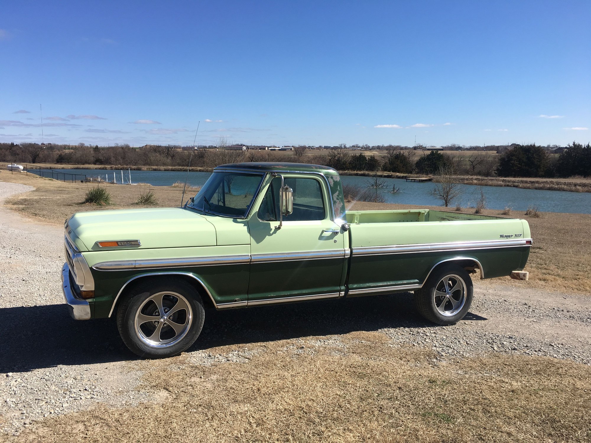

Pretty much the same truck as yours, the more I look at mine the more I appreciate the original colors on these trucks. There is a member on here goes by FILTHY, he has a nice color combo, looks like boxwood green and a creamy yellow that really compliment each other.

The old truck colors really stand out in traffic or a parking lot. That green will look cool on your Camaro. I wonder what a matte boxwood green would look like?
