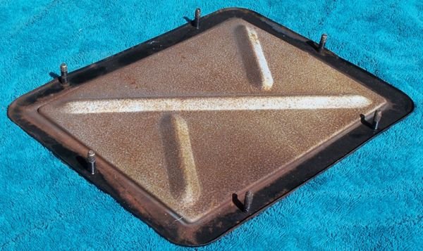

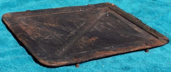

The "Cover Assembly - Heater Delete, Floor Opening" is part number C1UB 89018A08-A
The cover requires six 1/4"-20 self-threading nut/washer, which is part number 370546-S100
The gasket between the delete plate and the floor ("Seal - Heater Delete, Floor Opening Cover") is part number C1UB 8901810-A
bottom of the plate
top of the plate
