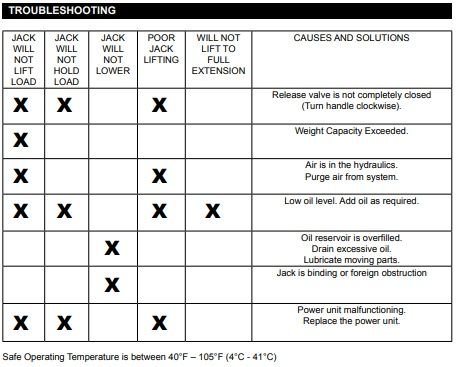

Your bottle jack needs new seals. Get in touch with Torin, and they will send you a set of seals, o-rings, & gaskets. Refill with fresh hydraulic fluid, and your jack will be fine.
You can own a bottle jack forever, if you purge excess air trapped in the hydraulic system, keep the hydraulic fluid at the right level, change the hydraulic fluid as needed, & refurbish with new seals, o-rings, & gaskets as needed. Always use hydraulic jack fluid. In theory, with the right fluid, the seals, o-rings, & gaskets are conditioned by the fluid as you are using the jack.
Your floor jack is the same. Remove the cover plate, and you will see a bottle jack. Same rubber plug for checking and adding fluid. The piston drives the lift mechanism to raise the jack saddle. Keep the extra moving parts clean and well lubricated. Service the hydraulic system accordingly. Replace wheels when worn. No reason why you can't own it and use it forever.
For anyone who does not want to do all the maintenance, I don't blame you. That's why there are hydraulic service shops. They can work on your jack.......usually for far more than the cost of buying a new one. Do you really want to pay $250 to have maintenance performed on a $15 jack? Jacks are cheap. I've paid as little as $11 for a 6 ton Craftsman from Sears.
Think of something simple......like an elevator. They replace the fluid as needed. They purge air from the hydraulic system. They fix any leaks with new seals, gaskets, and o-rings.
