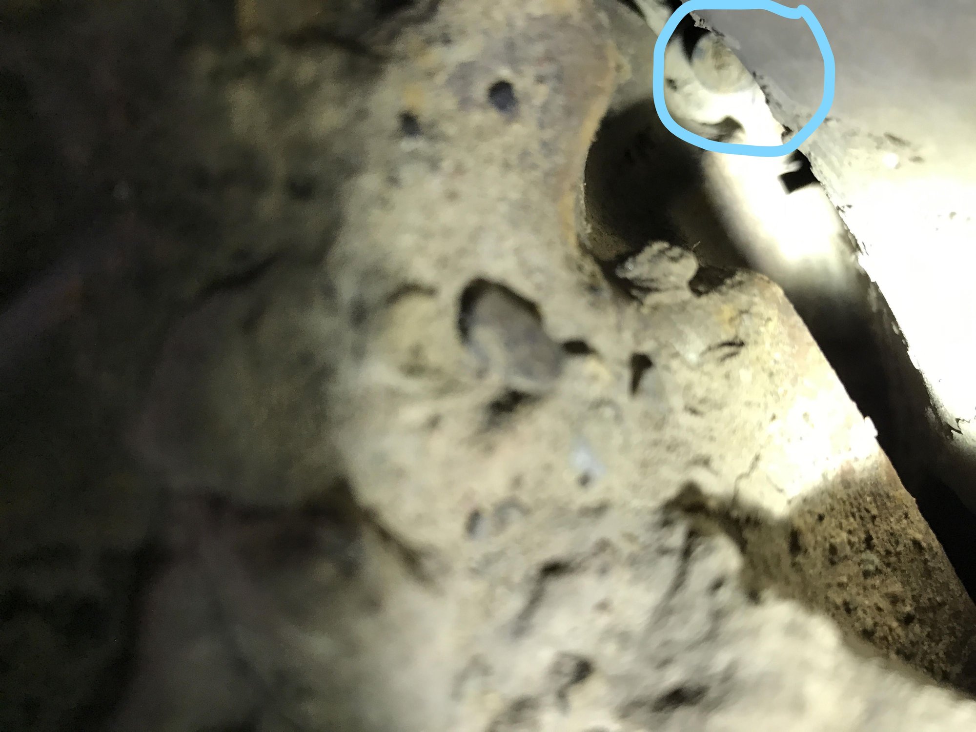

abs sensor holes just have a sensor plug looking deal in them. all the wiring is there. no abs light and the bulb isnt burned out since it lights up when turning ignition on. I circled where the sensor would go you can see the plug...

While it's called 4 wheel ABS, there are only 3 sensors. One at each front hub and only one at the top of the rear differential housing; the front sensors being different from that in the rear. My friend's '00 F350 XLT 4x4 did not come factory equipped with 4 wheel ABS, while my '01 F250 Lariat 4x4 did. I do remember working on trucks that were "stubbed" for front ABS, but were not equipped with them. As Scott stated above, it was optional in different trim levels for those years.

Hmmm E99 here. Build date 10/98 and no front sensors...only sensor on the rear diff.
I know that nothing is missing from the front end as I have just basically rebuilt the front hub/bearing/steering on the truck all the way to the steering box. No harnesses, no sensors. Just brake line and vacuum line
