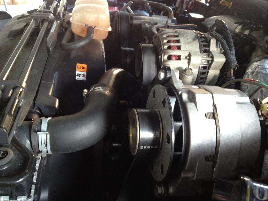

The unit itself is universal and can be run on just about any truck. I just purchased the 7.3 mounting kit so I would not have to go the BUBBA route and I wanted a clean install. I have also seen people purchase small engines (like a Honda) and rig up the unit to run that way. In the photos, the unit is on the right with the ALT on the left.
weld 1
weld 2
Old Mar 14, 2017 | 03:59 PM

Here are a few more pics of the unit installed to give you a better idea of how it fits in there...
photo 4
