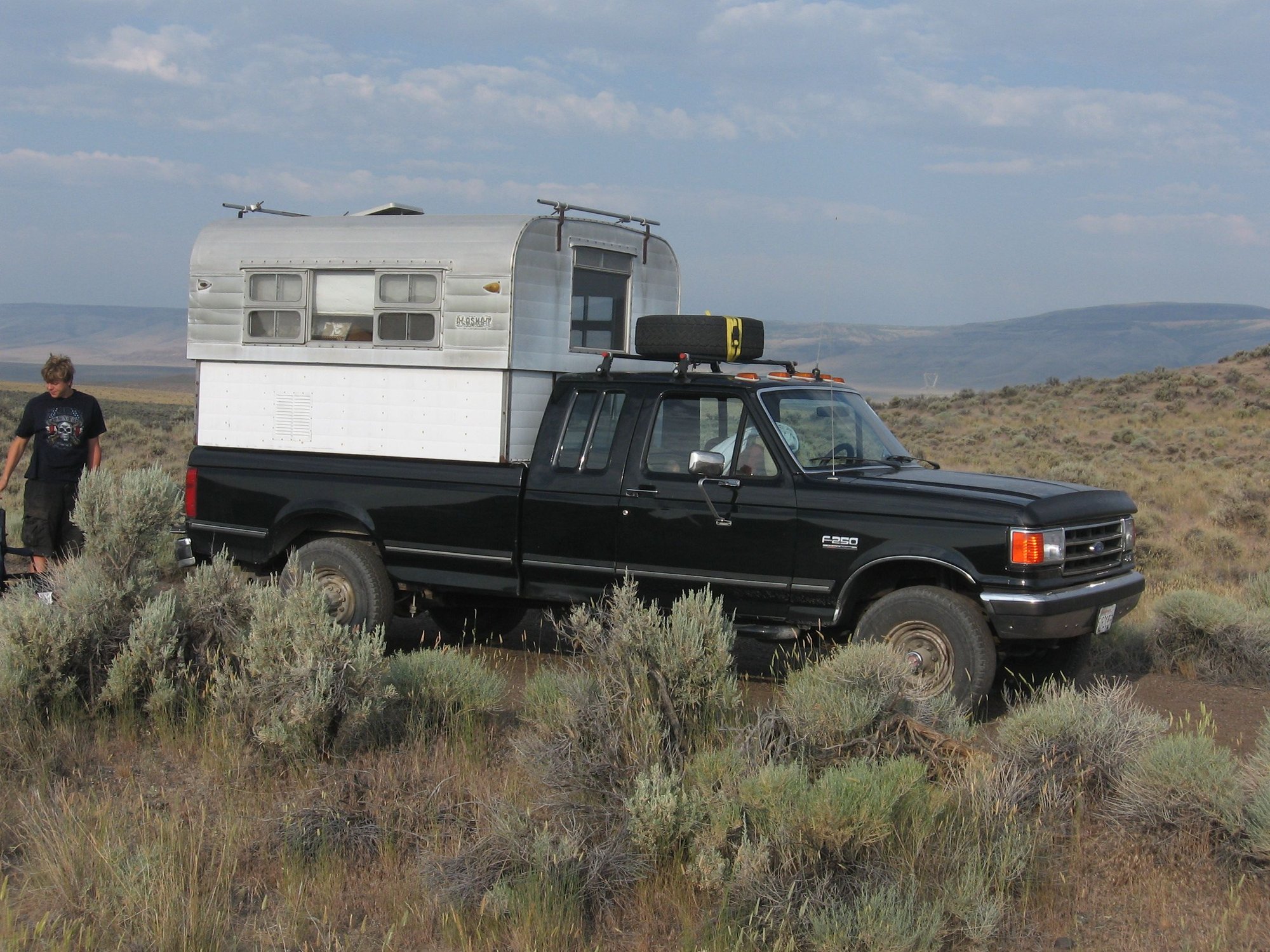

Performed some long overdue maintenance on the 1990 F250 HD 4X4 5.8 and ZF 5 speed. It carries an Alaskan camper, and I spent the better part of a week on it off and on to get it right for summer.
