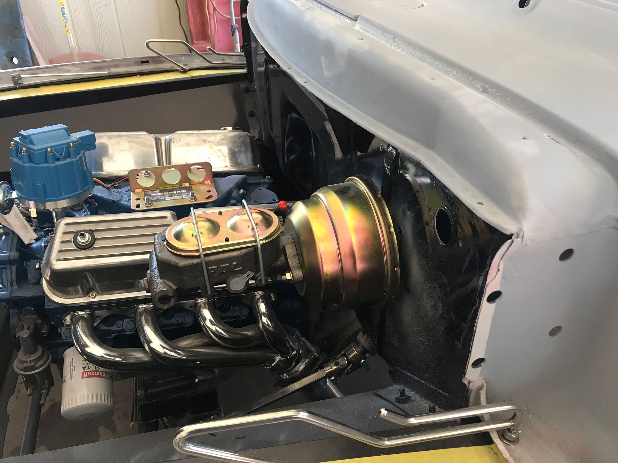

I managed to get the brake booster installed today to test fit it, now I need to figure a way to mount my clutch pedal and accelerator... I'm guessing I need to break out the welding machine once again.
What's the best way to paint a brake booster/master cylinder? I'm thinking of using a single stage gloss black but I don't have any experience with single stage. Do I need to prime it before? And will it hold up to the brake fluid spills?

I tried POR 15 and caliper paint on mine but may have added brake fluid too early. It pulled the paint almost immediately. I think powder coat would stand up to brake fluid.

There is no paint that I know of that will stand up to brake fluid .

so so the booster I used is the CPP F-100 firewall mounted booster, I do believe this is the corvette style booster. Everything mounts very easily and it ďtriangulatesĒ the dash to the firewall making everything very rigid. My new challenge is how to mount the clutch pedal without contacting the brake mount but I think Iíll be able to make it work.
Im upset about no paint being able to withstand brake fluid, after researching it seems powder coat wonít hold up well either. Iím thinking Iím going to get a black single stage and just paint it and hope for the best.

There are companies offering paints that they claim to be resistant to brake fluid. Eastwood has a rattle can paint and KBS says that their Diamond clear coat will withstand virtually any chemical found in an engine bay.
