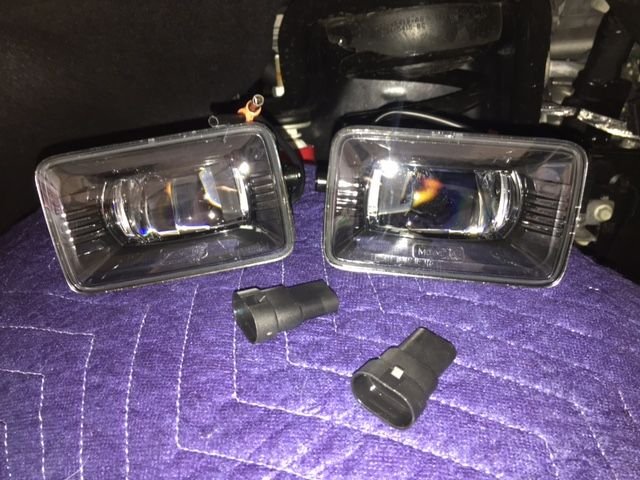

So, I installed these lights yesterday. Honestly, I didn't find anything really wrong with the OEM fog lights, but I had a gift card to blow and thought this looked like a fun little project. I pretty much followed the Stage 3 Motorsports video tutorial. Stage 3's 2017 F250 Super Duty Project Truck Step One Mind you, I don't have all the air tools, etc that they have. I pretty much made due with a socket set, short and stubby flathead screwdriver, 90 degree adapter for my power screwdriver/drill, and a work light. I was also able to do the project with the wheels and tires still in place and the truck on the ground. Just crank the wheel TOWARD the direction of the side you are working on. First light took about 30 minutes, the second about 15 minutes.

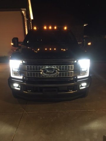

Ok, I was able to get some better pictures. I think the lights are a little better than I thought, but still not leaps and bounds better at all. They appear better than last night which I attribute to the rain and water in the air and on the lenses. I re-watched the video and they seem to be making a comparison between the OEM Halogen lights and the Morimotos. In that case, I think this would be a vast improvement. But as far as I can tell, my fog lights on my F250 Platinum appear to be LEDs (although they look to be the same as the ones in the video). Maybe that's why I'm not "blown away" by the difference. I did measure the upper line of the lights cast on the wall from 25' away for aiming when the OEMs were installed and approximated the Morimotos to the same line for the upper level of the lights. Definitely do not see the same light cast downward in front of the truck after install.
As a funny aside, the technician in the video puts the metal plate back improperly in his reassembly. On the engine side, the plate is supposed to be placed BEHIND the bracket. I'm just being a jerk, but I almost made the same mistake.
OEM Lights
Morimoto XB LED Lights
OEM Lights. Should have turned on parking lights instead of full in retrospect. But look at the crisp line on the driveway.
OEM Lights. Closer view.
Morimoto lights. Note the ground lighting. It might be that these are a narrower band and need to be angled lower in comparison to OEM?
Morimoto closer view.
IMO, I don't think these are a great improvement. Maybe similar at best. If I have time this weekend, I think I will pop one of the Morimoto lights out and re-insert an OEM light and then take pics. Will also try to re-create the line of the light as in the OEM setup with both lights. I had planned to do that the first time, but ended up installing in the daytime and needed to get the project complete. Also, it was raining on the way to work this morning so didn't get much of an on road effect of the lights.
Wonder what the return policy is with Stage 3 Motor Sports????
Sorry for my amateur review. I'm sure there is probably a better way to objectively compare them. I'm open for suggestions, time permitting.
