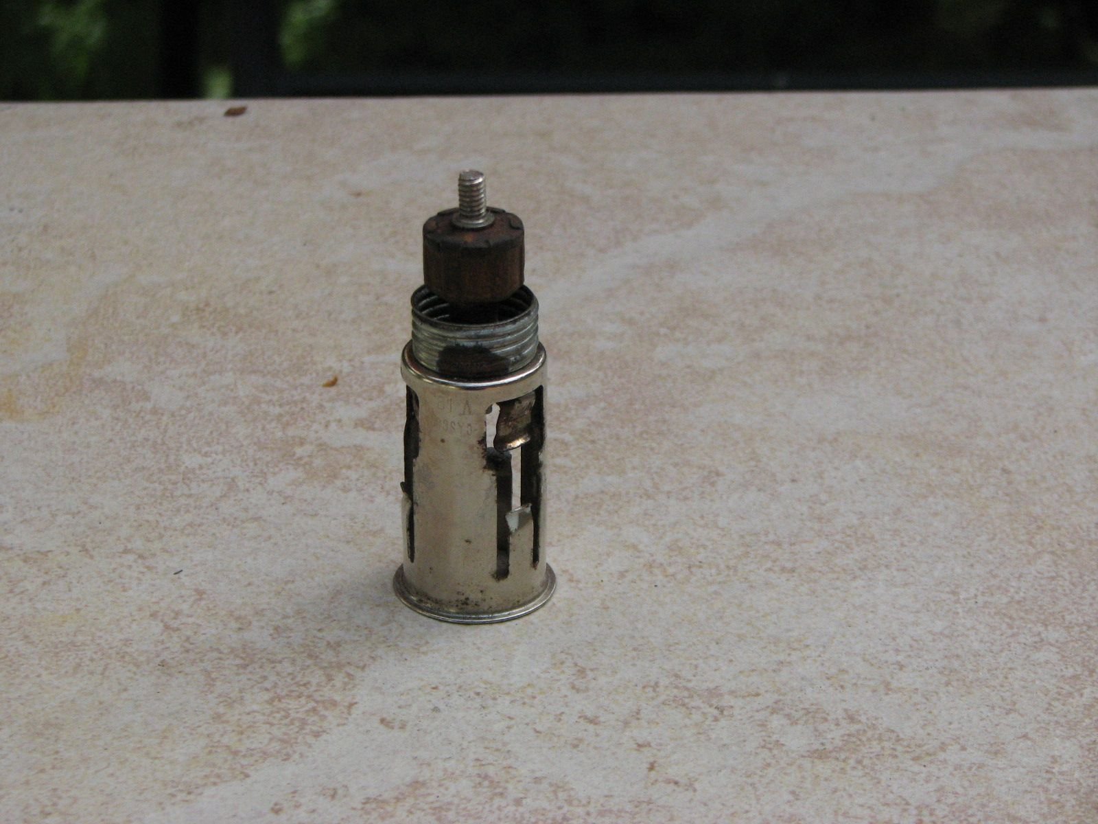

Depending on your sequence number in your VIN, a person can still get the parts NOS from some of the vendors. If you are before 648,001 then likely these.
Cigar Lighter Socket and Retainer Assembly C1TZ-15055-A
Cigar Lighter Lamp Assembly C3TZ-15072-A
The housing around the lamp just sort of snaps into the slots in the socket and retainer. So a gentle squeeze on the lamp housing and it can be released from the slots.
The fuse is in the middle of the picture and came with this socket and retainer on the left. There is no reset hole in this fuse.
Chad

Chad, thank you for the info!. I have a couple spare element and light bulb housing, now it's a matter of waiting components to arrive so I can reassemble the ignition switch and test the lighter.
Appears the 'china' housing has some type of Dookickie sticking out the rear, similar to a pin for an electrical connector would attach to? Not clear to me how the light bulb and housing would attach; thus, intend using the 'china' element with the original housing, can not see why it would not work?
IMO, feel my 'go to' Ford part supplier's, except for a few items. no longer carry the quality merchandise I use to rely on. Intend sticking to selective few suppliers who offer OEM/NOS merchandise.

The barrel shaped lighter fuse threaded onto the socket, then the wire slipped over the threaded end of the fuse.
The original factory installed fuse had a hole in it, used for resetting it. The replacement fuse may or may not have the hole.
The "gypo" socket is different than the original, has a place for a wire to attach that no 'genuine Ford' socket of this era came with.

C1TZ-15055-A .. Lighter Socket & Retainer (see Chad's pic in post #17) / Obsolete
1961/64 all trucks (except P Series Parcel Delivery & School Bus) / Ditto 1965 before serial number 648,001.
NOS PARTS LTD in Waxahachie TX has 1 = 972-937-2201.
GREEN SALES CO. in Cincinnati OH has 2 = 800-543-4959.
D3TZ-15055-B (replaced C5TZ-15055-A) .. Lighter Socket & Retainer / Obsolete
1965 Trucks (except P Series Parcel Delivery & School Bus) from serial number 648,001 / Ditto 1966/79 trucks & Bronco's.
MILLER OBSOLETE PARTS in Binghamton NY has 1 = 607-722-5371.
GREEN SALES CO. has 7.
