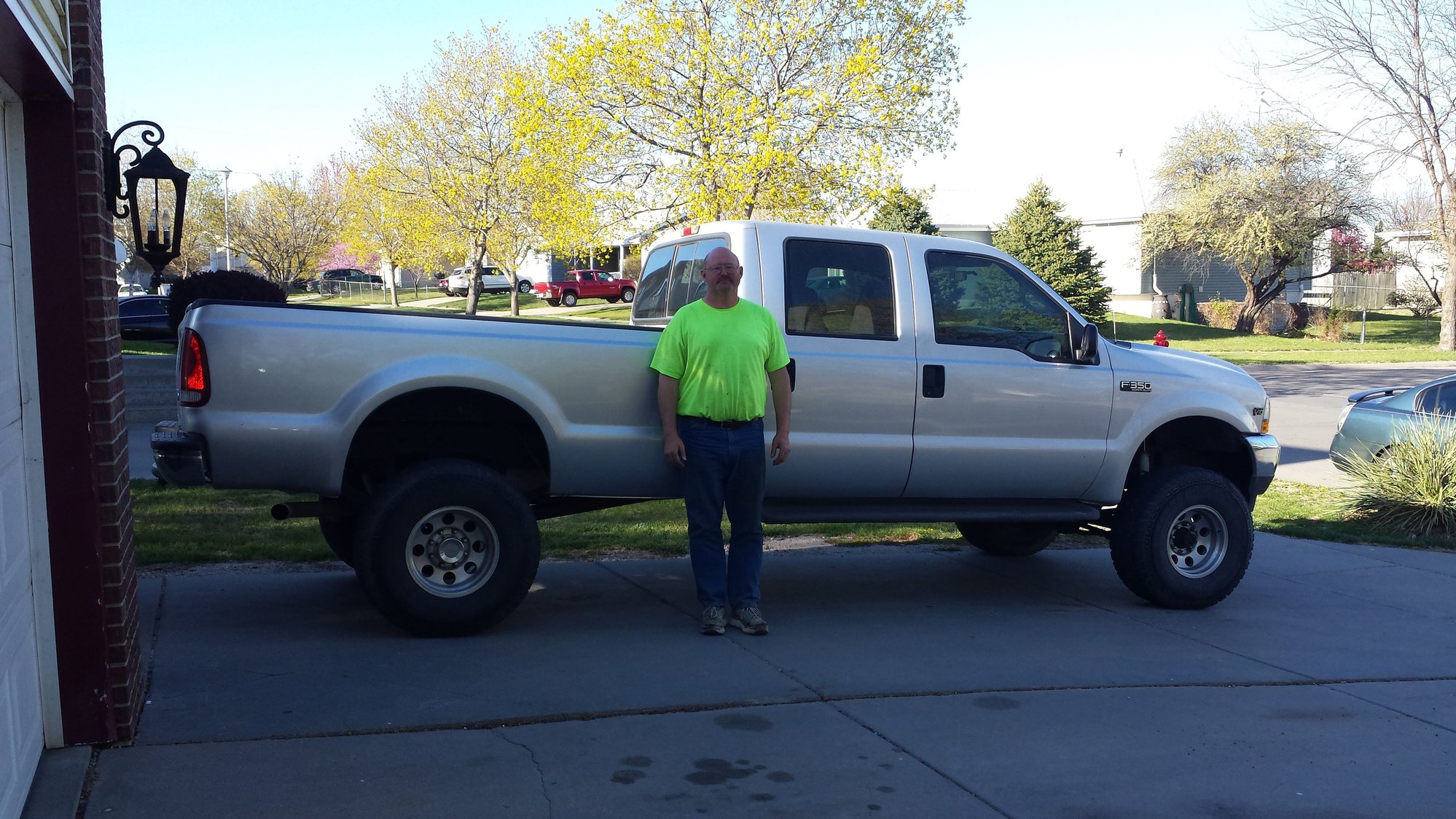

1500 rpm's
This is my truck

Originally Posted by poncadad
1500 rpm's
This is my truck
She looks like she's in great shape.
