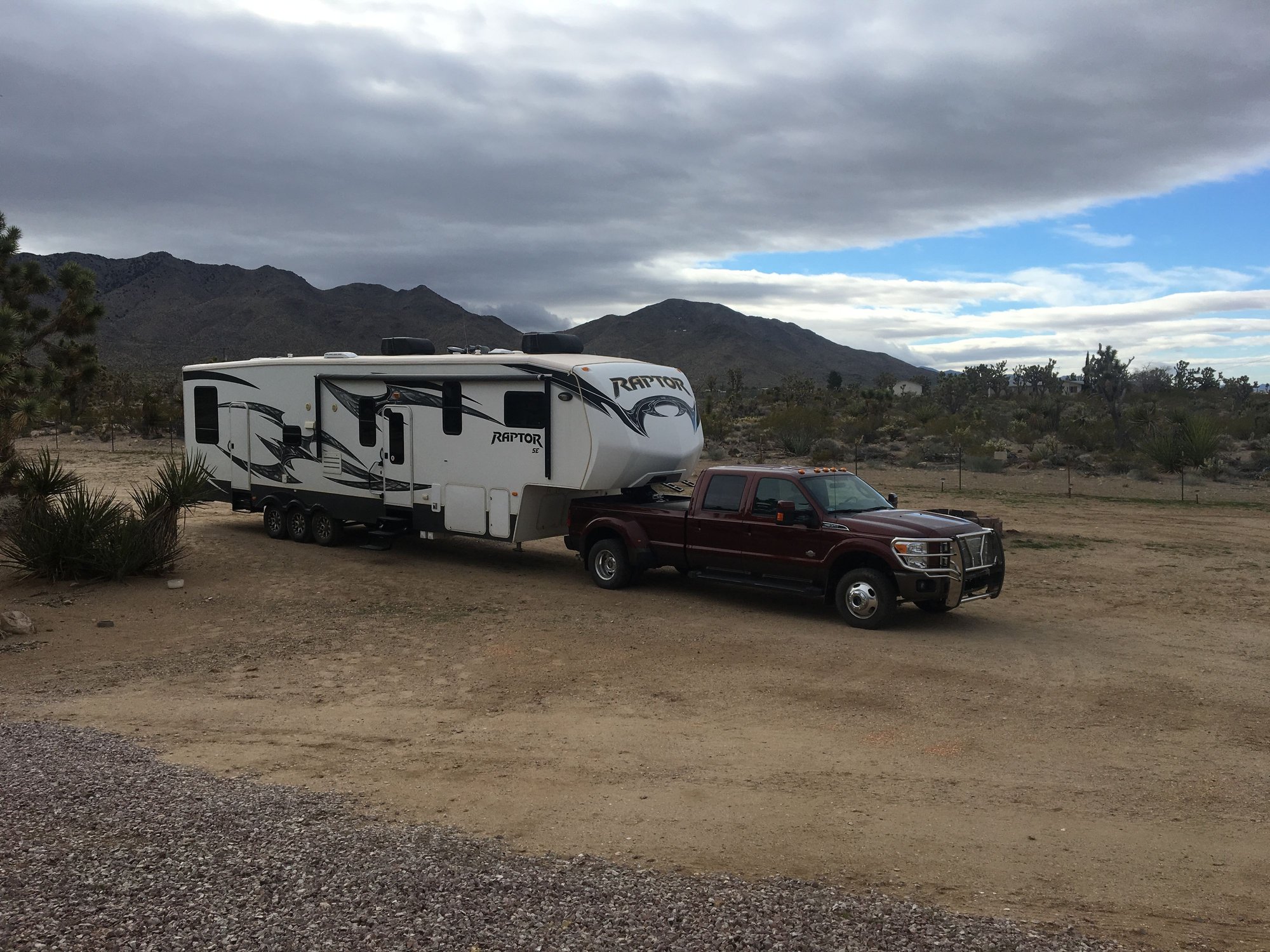

Well, I think everyone in the world should think about "practical" instead of "want" !!!!
Do I NEED a 40+ft toyhauler to haul my Polaris RZR (needed toy?)?? Pulled by a 2016 F350 KR DRW PSD??
Do I really NEED in excess of 400 HP to run around in a 3600lb car???
Hell, I am over 70 yrs old, so the NEED part of the equation answers that!
But life is too damn short to be "practical" all the time!! I have more regrets about the things I haven't done than the things I have!!!!
