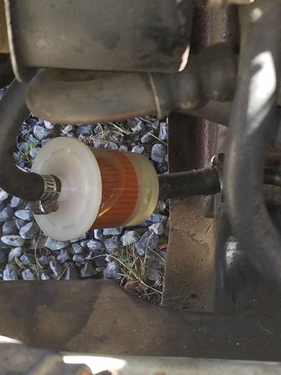

Old Mar 4, 2017 | 01:21 PM
Ford Joe's Avatar
Ford Joe
Joined: Mar 2017
Posts: 18
Lower fuel filter between tank and pump.
Fuel filter between pump and carb
These are a few shots of my fuel filters and their fuel levels while running.
