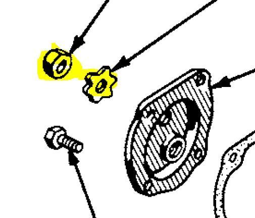

LOL, you're missing the "star" washer and locknut, easy to see why it's changing.

That screw that you were told to "leave alone" is a critical adjustment. The hole on top is for lubricant fill. A search on the forum should reveal the adjustment procedure for the box.

EDIT: Ray, I found that you just trun the screw to stop with fingers, than tighten lock nut while holding the screw still, does this sound right?
Wasn't on there when I got it off the old truck, and the original box was too gunky for me to see it. I just went outside and knocked off the gunk.....yep, there it is, a lock nut.
Took it off the old 3cc03 box and onto the 4cc07.
Thank you for the help Ross. Always there to keep my truck from falling apart.

I think you'll find you need the star both to hold adjustment and to keep oil in the box. Not sure who would sell them, but someone on here must have an old one laying around.

Actually, I think I have one and I'll try it out tomorrow. For what it's worth, there was no washer on the box it came off of, and that hasn't been touched by anyone since it was bought in '87. There was no leak and it doesn't appear to have moved anytime recently.
I'll still put a star on there tomorrow or I'll find a copper crush washer. Thanks again Ross and ray.

I think you'll find you need the star (steering thrust screw lock) both to hold adjustment and to keep oil in the box.
78-3564.. Steering Thrust Screw Lock / Obsolete
OBSOLETE RELIABLE PARTS in Nashville GA has 11 = 229-686-5101.
