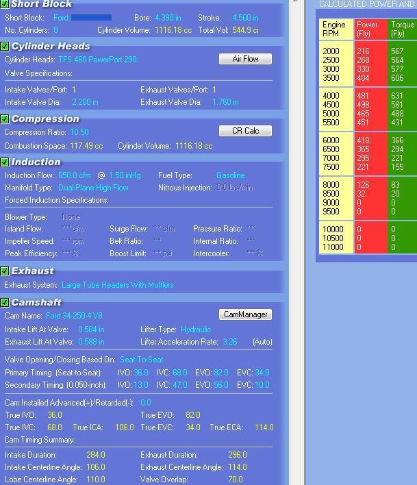

also after speaking with a few guys and doing a ton of research i have chosen the following.
cl34-250-4 for my cam
tfs-53410001 for my heads
EDL-7566 for my intake
now i have not bought anything yet so im still up for some discution and opinoins.
the other question i had was about compression.
-38 dish pistons 74c chamber and deck height is unkown.. will my compression be to low? i dont want it to ping but at the same time efficency is always nice.

What pistons are you considering? What block are you using (early or late)? I can crunch the numbers and tell you both static and dynamic compression ratio with your cam choice. The cam is probably leaving some power on the table. Many guys running big inch strokers end up going with a custom grind.

This thread might be better covered in the performance engines 385 subforum farther down the board.
Yes, deck height changed around '73
But with a .045 head gasket you are losing quench if your pistons are anywhere in the hole.
Pin height is just another variable with a stroker kit.
The suggestion of a custom grind is always a good one, and a large part of my suggestion for buying a 'kit' from one of the builders that have done this *many* more times than any of us as individuals would in a lifetime.
Tires, gearing, weight, headers, miles to be traveled etc all play a role in choosing a combo that will help you actually drive this on the street.
600hp is not too hard given the money you seem to be ready to sink into this, but you are always going to have problems getting it to the ground.
Breaking **** left and right gets old fast.
