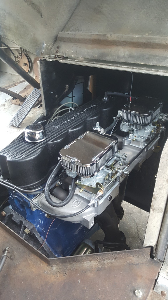

Old Jul 11, 2018 | 03:24 PM
TA455HO's Avatar
TA455HO
Lead Gopher
Joined: Aug 2012
Posts: 10,062
Likes: 1,615
From: Seattle
Looks like it could be a 240/300 which are good engines. Is the engine mounted with front and back mounts? If so, is the back mount under the bellhousing? I'd then wonder if that is same bellhousing as a 4x4 truck might have used or something unique to the Parcel Delivery. I guess more research would be in order.

would love more information on exactly what Clifford parts you added ?!? I have nearly an identical rig and would love some help sourcing parts you have used to restore your rig. Thanks!

BWheels hasn't logged onto the site in just about a year. As far as the Clifford parts - the manifold, carburetors and air cleaners are part of what is known as their 6=8 package. They claim 120 horsepower increase and 120% torque gains and 10MPG increase over stock.
https://www.shop.cliffordperformance...-7001F300K.htm
Chad
Old Jul 24, 2018 | 12:23 AM
  #29
BWheels's Avatar
BWheels
Joined: Feb 2017
Posts: 10
Clifford parts
I pretty much bought everything that Clifford offers. I'm running the dual 38mm Weber on the custom intake manifold plus the headers, cam, and timing set. I also converted it to an automatic with an AOD and Lokar shifter. Of course the overdrive meant a rear gear change in the Dana 60. I would warn you that the guy who now runs Clifford is the original guys son in law and not all that knowledgeable.
