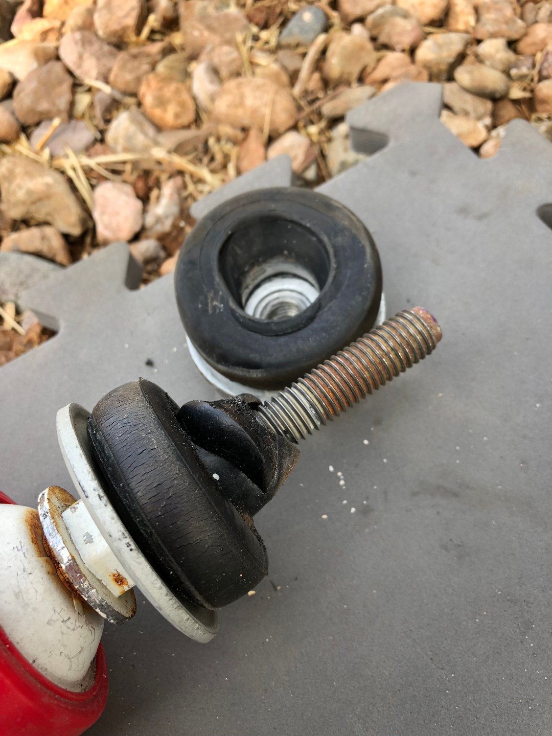

Installed Rancho 9000XL's today on my 350 Dually. The install was pretty straight forward, rears were very quick and easy, fronts took a little more time since you are working in a pretty confined area when doing the tops - still an easy job overall particularly considering I have never changed a shock before in my life
Stock Ford FX4 "Rancho's" that came off with 7,500 miles on them in mostly dry conditions since purchase, no snow, salt, bad stuff and look at them. Just posting a pict of one of the fronts that Ford did a fantastic job installing the bushing on too.
One last minor thing that I had not seen mentioned anywhere, the stock front top nut is 21mm and tight getting a socket wrench in there with the bedliner, which I knew, so I picked up a 21mm ratcheting wrench which worked great getting it out. Unfortunately Rancho provides you a nice new 3/4” nut to go back on the new shocks so that 21mm ratcheting wrench quickly became worthless for that job, that part I did not know.

I think my bushing looked just as bad on my non-Rancho OEM shocks. I agree with the nut spec being different. Would be nice to not need so many tools.
