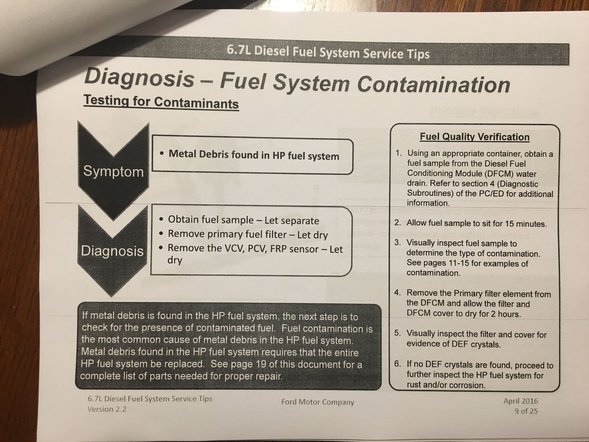

Just been informed by the dealership that Ford will not warranty the engine if they only flush the fuel tank and lines. Ford service manual says to replace the entire fuel system whenever the fuel system is contaminated with DEF. That includes all 8 injectors and high pressure pump and all lines. Insurance company is arguing with the dealership saying all of that is not necessary. I'm going to insist that the insurance company pay to have what Ford recommends per their service manual or they can total the truck. I'm not driving the truck without a warranty on the Diesel engine. My extended warranty is worthless also if they don't follow the repair guidelines. I'm probably going have to get an attorney involved in this matter.
Insurance only wants to flush the tanks and fuel lines and replace the filters.
I just want my truck repaired per the guidelines from the Ford manual so my original warranties remain in effect

Just goes to show you not to take it to the dealer for this... there have been many cases like this (and even worse) where just draining and flushing is all that's needed most times.
The counter is that if you do ever have an issue and it was caused by the DEF, you're on the hook there. You're effectively putting the warranty at risk, and I promise you some of that $8k sale price is to cover the warranty.
Third picture does qualify that it was turning on the ignition that forces all this to the HP system, though still would require showing of contamination. I wouldn't want to chance it myself. It sounds like your insurance is covering you (little difference between this and any error of judgement that causes damage, I dropped a canoe on my brothers Triumph Spitfire. Damage caused by human error is a big part of insurance claims.

Thanks for the information. Metropolitan is having some fuel contamination expert to take sample at various locations on the truck for some unknown reason. I told the lead adjuster today that if they expect me have the truck taken to another shop it would be another Ford dealer. The best friend I have right now is my service advisor who is insisting there is only one way to repair this and that is to comply with Ford's advice.
