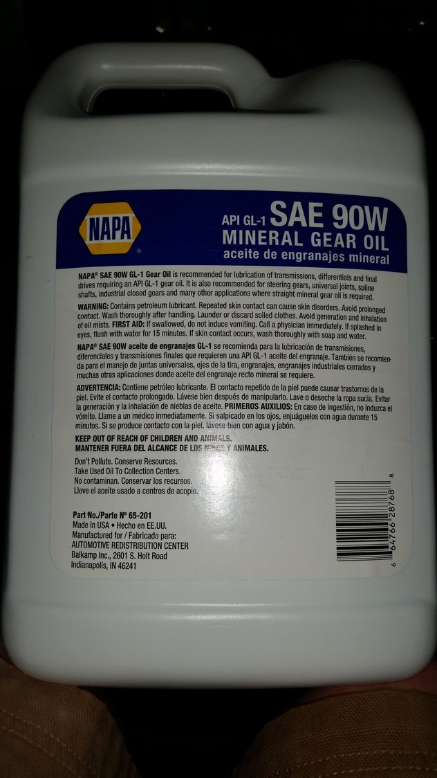

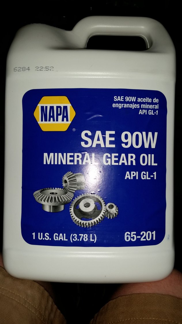

T19 fluid swap.
It's my first time doing a fluid swap in a manual transmission. I read a little bit about it. From what I understand the oil I use should be at least gl-4, not any higher. If possible I should look for a gl-1 rated oil. Well I found a gl-1 rated 80w-90 gall on for 15$ at napa. What do you guys think?https://www.napaonline.com/en/p/FCA65201

Ive ran that in rearends with no problems. Probably ingorance, but imo gear oil is gear oil

It will work. If you do a lot of towing you may want to run a GL with the EP (extra Pressure) additive. GL-1 is for light duty gear applications. GL-4 is probably better. That being said, It's a T19....You could probably fill it full of banana peels and it would still shift.
