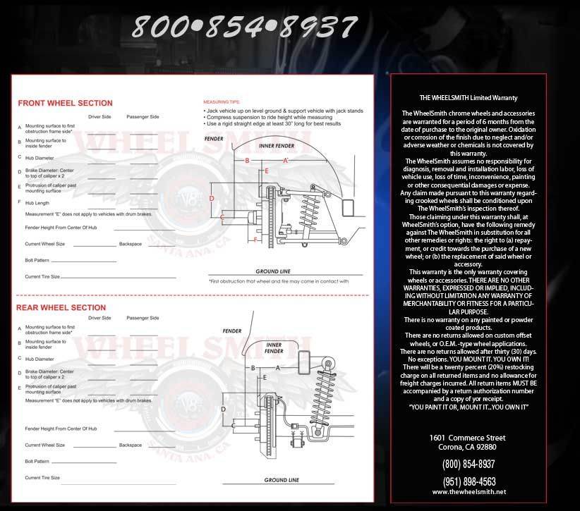

You might want to use this form to determine backspace.
Wheelsmith - Artillery Wheels and Accessories
