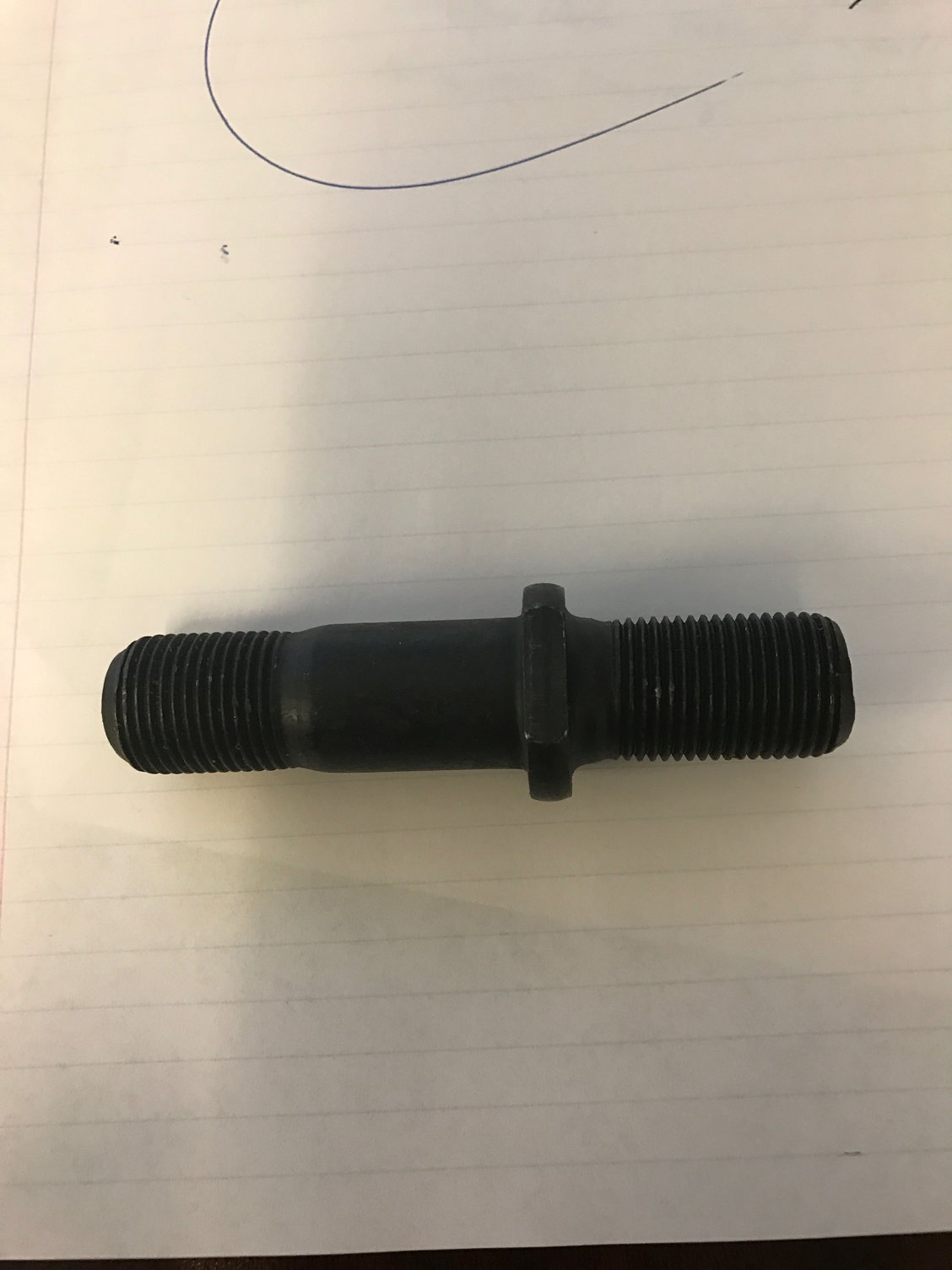

Hey guys I have a question about which end of the stud is seated in the hub. I am having adapters made and bought new studs. Is the left end the end that is threaded into the hub? This is a silly question just want to make sure. I assume it's the left hand side that goes in the hub.

The left side has a shoulder, and they also appear to be different thread sizes, 7/16" and 1/2". The shoulder side would go where there are shear forces.

thank you. They are both 3/4-16. I assume they look different cause the angle the picture is taken.

Is it just me or do the threads on the short side look left handed?

Thats cause they are. Good eye! I purchased different studs and sent these back though. Had a bit of a mix up with part numbers obviously...
