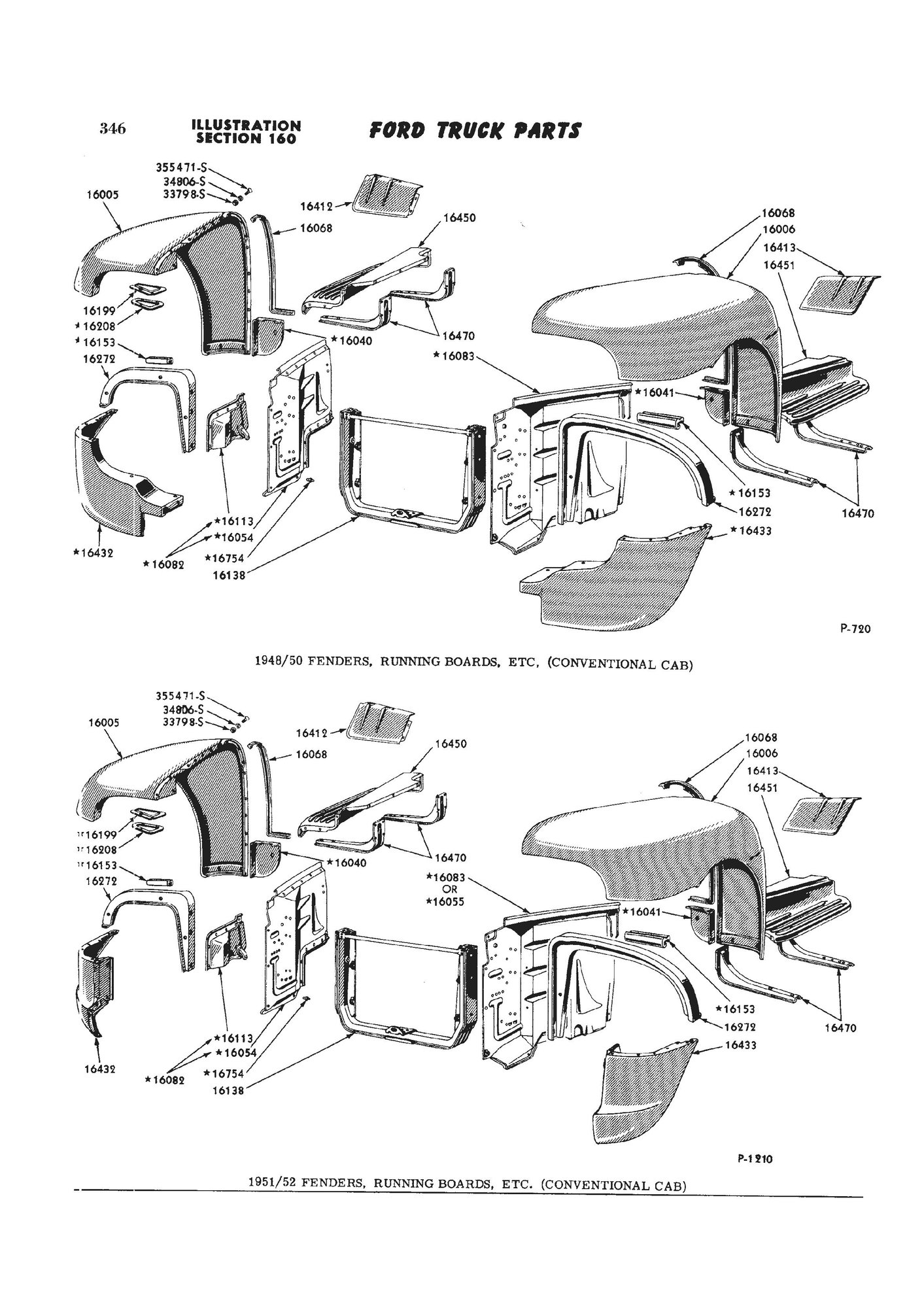

7C-16272 .. Support-Front Fender to Fender Apron / Obsolete
1948/52 F1/F6

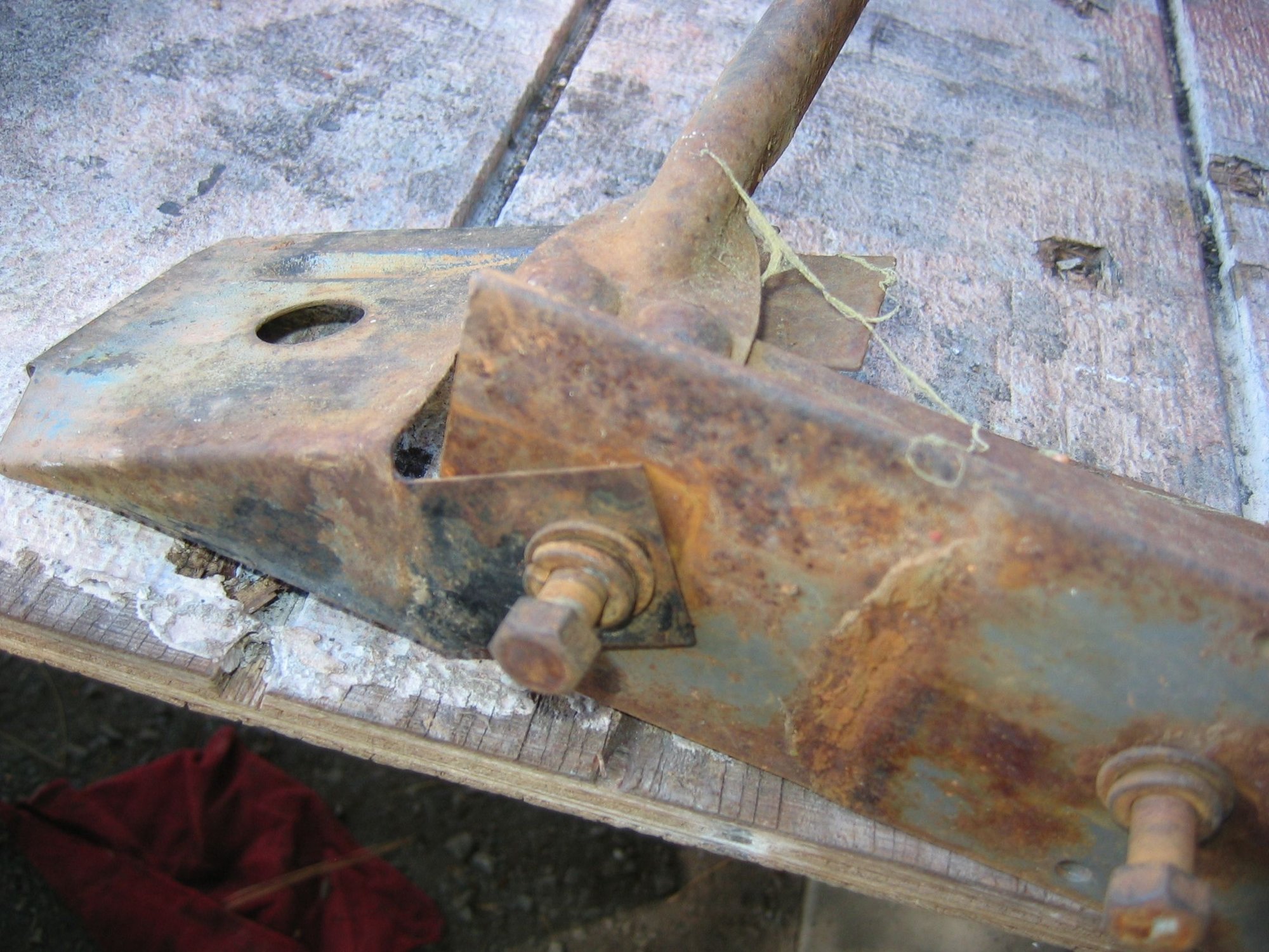

Here is a pic my brackets are set up at the forward position
Not as clear as I hoped

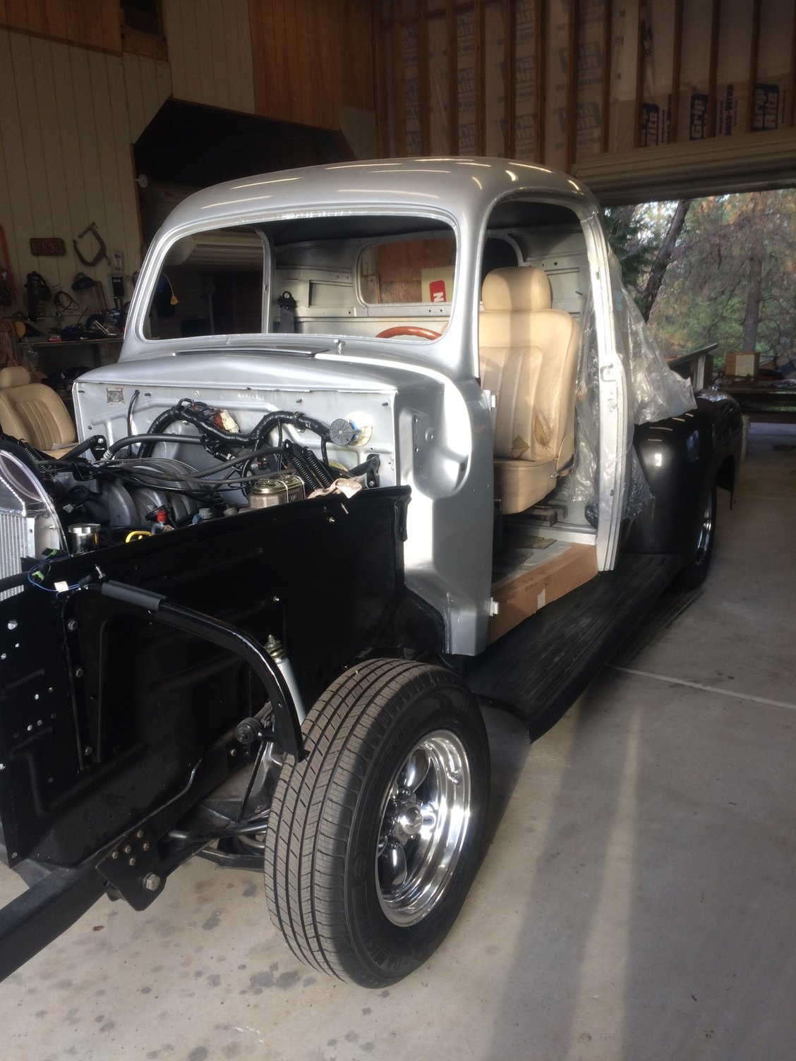

I struggled mightily to get my front clip back together. It was embarrassing! Some people on this forum can make a fender with a hammer, a bag of sand, and a piece of sheet metal LOL--and I couldn't even bolt mine together correctly. There's a thread I started awhile back that shows what not to do. As I mentioned, some of the pictures of my attempts are quite embarrassing.
I learned from patient experts here on FTE that getting your fenders on correctly is a matter of doing things in the proper order: Start with radiator support, then get the inner fenders installed. Next put your fenders on. Surprisingly, the last thing you do is the fender supports. Once I followed this order, my problems were solved.

Assemble everything loosely. And don't forget to install the pad #16153 in Bill diagram above. Then just snug up the bolts. Align your fenders then do a final torque.
That pad is important as it keeps the top of the fender from oilcanning. It also stabilizes the assembly and helps prevent fender cracking.

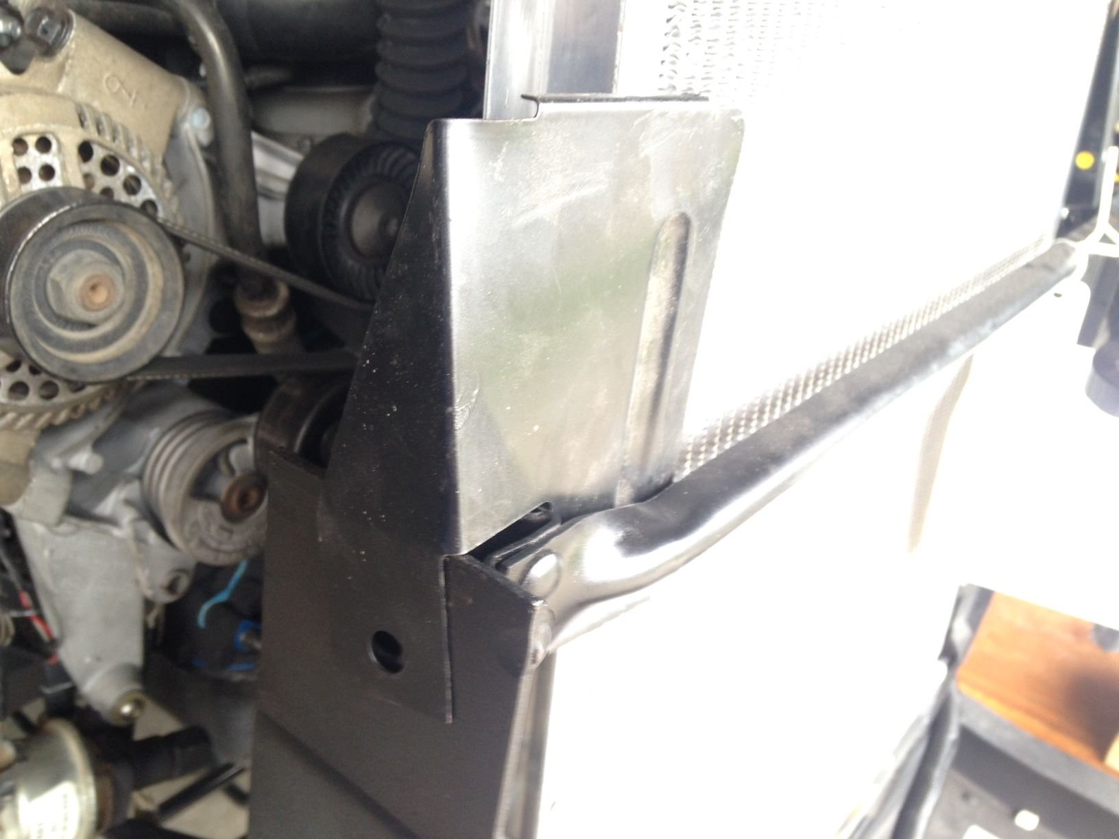

how about these upper air deflectors? is this how they go on? i don't see them in the diagram numberdummy posted, and have no memory from when i pulled them off...

I believe this is correct

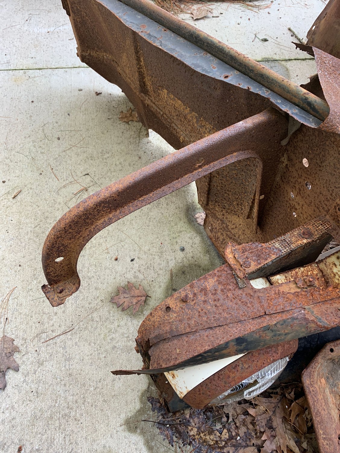

If this is what you are looking for send me a PM

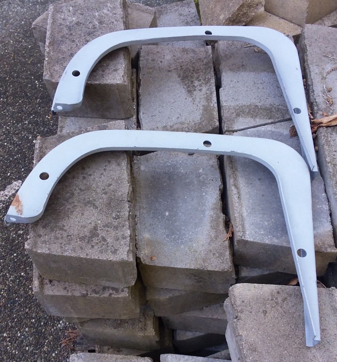

Here is the ones I have. You may want to check with Kevin first as he is much closer. (Shipping costs) PM me if interested.
