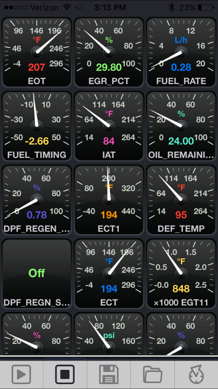

Since i have been watching regens via forscan app my regens are starting with dpf only 40-45%, anyone experience anything similar?
Twice in the same tank of fuel, once going south on a 7 hour drive and again headed back north, no idling running 70-80 mph
Also my app never shows the regen as "on"
I can tell by egt and timing
Since i have had truck i do one regen per tank
Anyone else experienced this or have some input?
Screen shot showing it took it all the way to 0, which it did last time
Am i looking at the right pid?

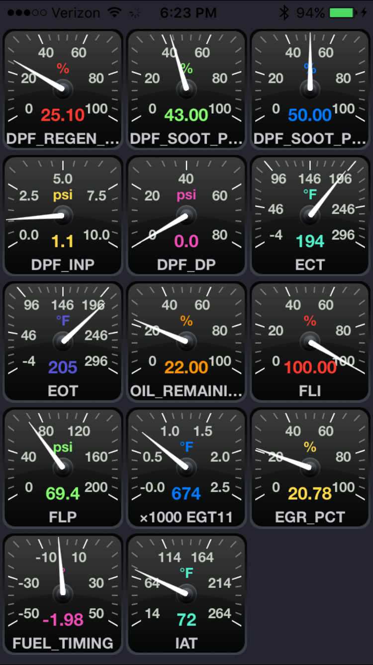

If the regen gauge never reads "on", how confident can you be that the dpf reading is accurate?

There are two DPF soot load PIDs that I've seen with the FORscan app. One climbs into the 40%+ or so before the regen starts, while the other is a bit more relative to a true percentage as we think of it, starting regens as the load climbs into the 90 percentile. You might try switching the PIDs so it makes more sense when you look at it.
My understanding is that the PID for regen status hasn't been updated in these apps yet and is thus not reading correctly. Eventually the programers will figure out with PID values will indicate regen on/off.

I Think the top right one is the correct one
