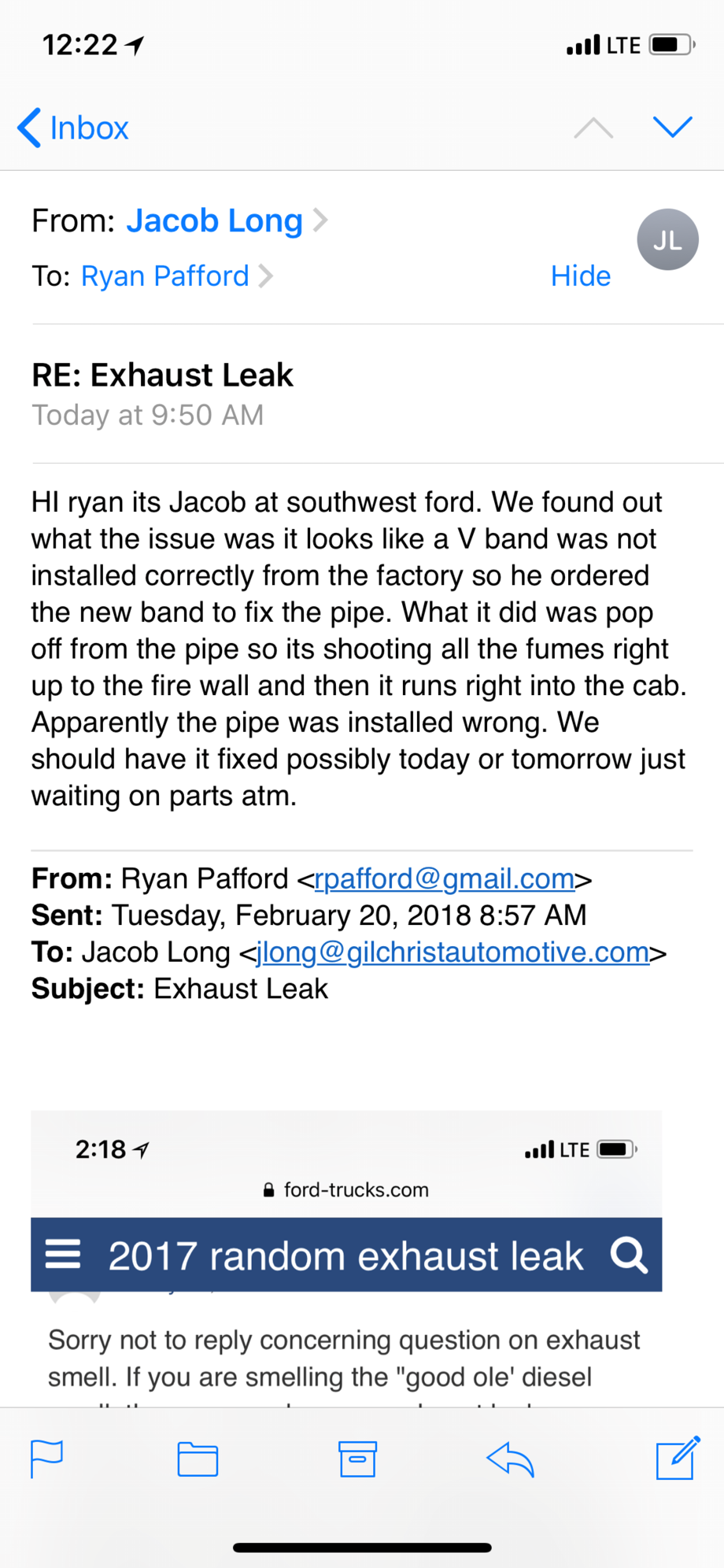

Old Feb 21, 2018 | 02:50 PM
  #30
Rpafford's Avatar
Rpafford
Joined: Feb 2018
Posts: 4
Update for my leak - it was in fact a leak and here is the email I got from my service advisor. Picking up the truck likely tomorrow and will follow up but it seems they found my problem.
