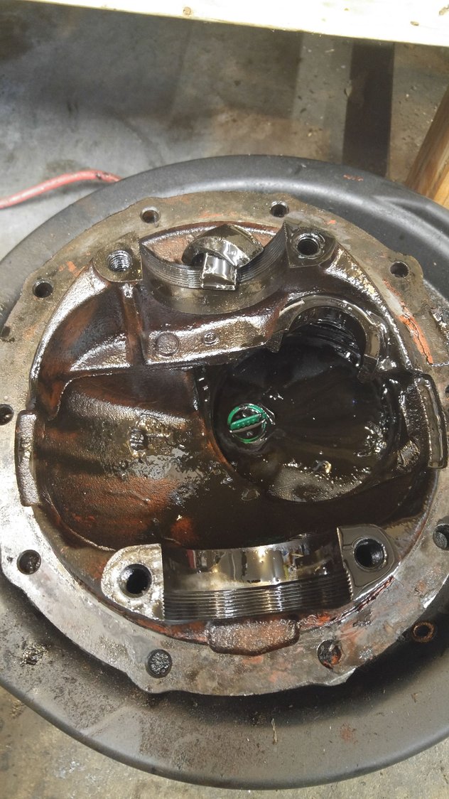

I got the center section out. Broke 2 teeth on the ring gear. Blued the pinion. The pinion support bearing came out of the center section. Carrier bearings are tight and blued. I figured for the worst and hoped for the best. Would be liked to have just done new bearings but since I got everything apart I'm going with a posi unit I think. I don't go off roaring but I've been in parking lots and a muddy parking lot that that I had to put it in 4x4 because only 1 wheel in the back got traction. Didn't really feel like doing any of this but it was something on my list to do so I guess it's all good just bad timing.

Ok. I did more damage then first expected.
There is no bearing left. Only the race.
Broke thw pinion support for the carrier housing. So i guess i got to find a new one as well.

Seeing this. I'm surprised I made it home. Started humming shortly into my way to work. And I made it home. 95 miles round trip. Could have ended badly.

Well, that all sucks. Like I said, look on CL for a complete axle for around $150. I don't think I would trust that carrier housing.

Nope. The housing is shot. The pinion support bearing broke. I found a guy on a Facebook selling site that has alot of 9" center sections. He has one already rebuilt with 4.11 gears and a posi. He wants $350. I'm probably going that route.

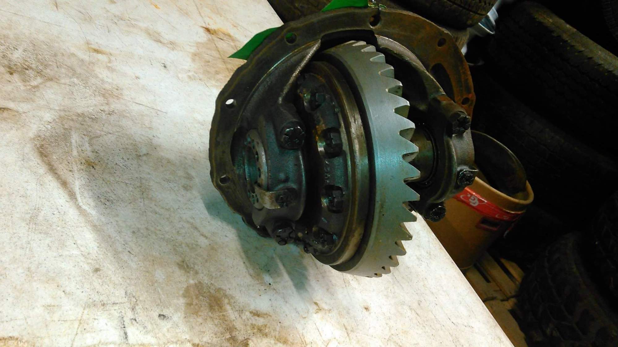

These are the pictures he sent me. I tried offering him $300 and he said no way and he had no issues selli gthem at this price. I figured it was fair.
He also had alot more.

Wow, thats a good price IMO, especially if its ready to go. I pulled my 9inch axle apart and found that same bearing nearly destroyed. Lots of play and movement, I was just lucky I pulled it when I did.
Can you share his contact info?

Where is this guy with all those 9s? For $350, that's a steal.

Great price!!!! Couldn't hardly buy cheap parts for that price......
