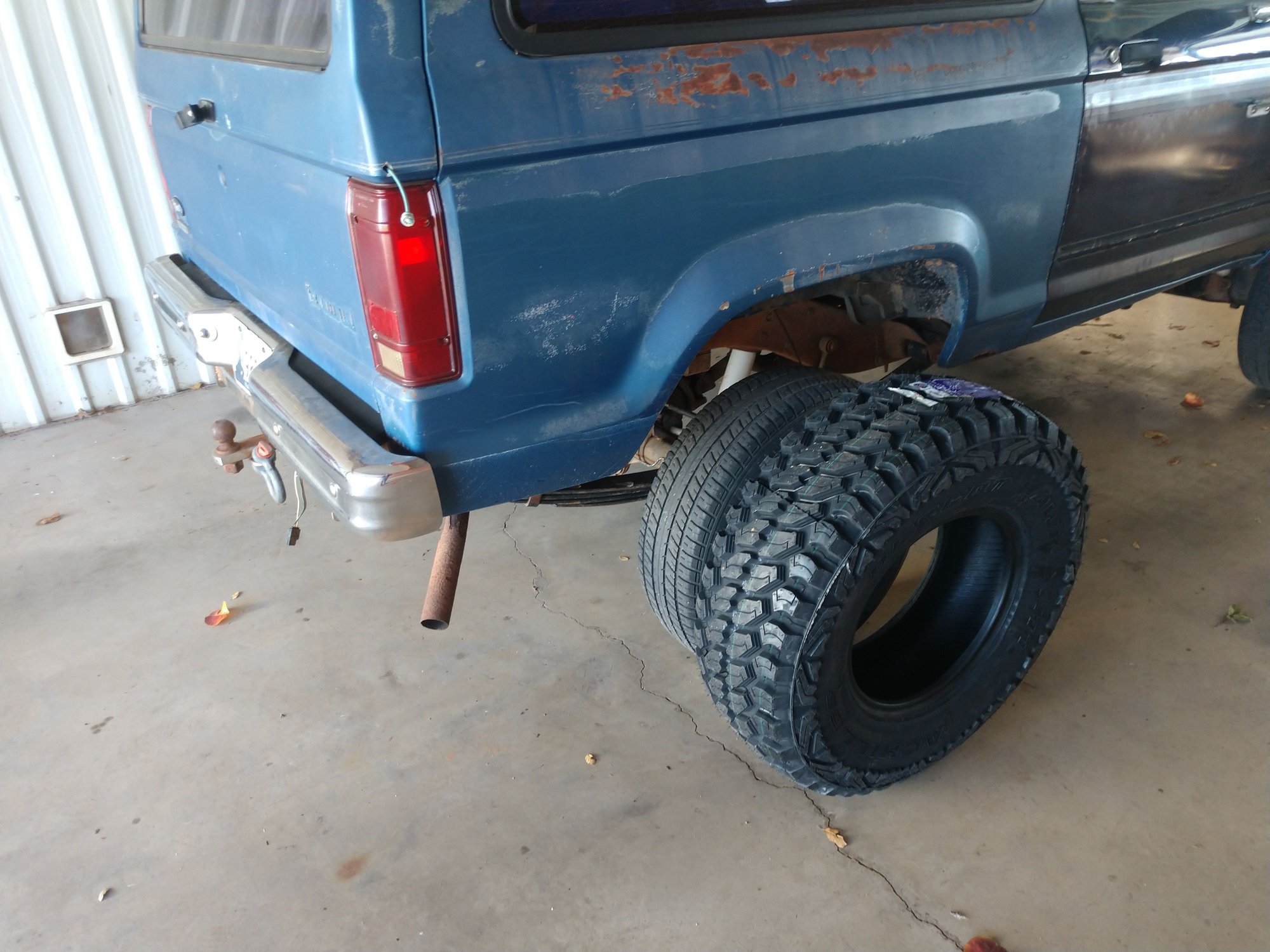

Got some 31x10.5 tires to put on it. As soon as I get time to clean up the aluminum wheels and throw these on ...

No more skinny legs. And pictures because we all like pictures. It is a bit more of a chore to chug these big meats with the little 2.8.
