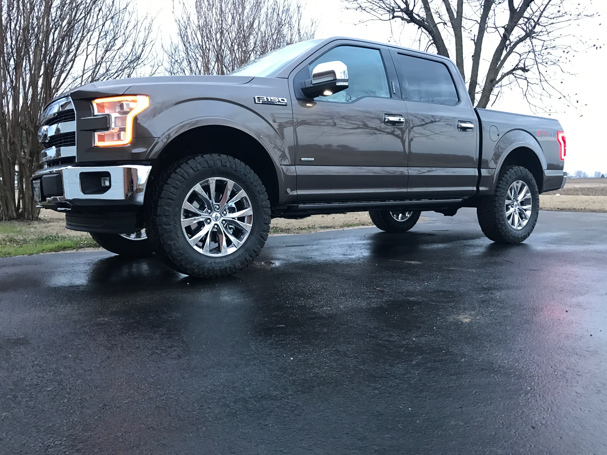

If you're keeping those wheels they'll fit perfect with no rubbing. If you're getting aftermarket wheels, get 5.5" backspacing on an 18x9 wheel to keep from rubbing.
My truck with the same wheels you have. 2.25" levelling kit with 34.3" tires.

I have the 35 x 11.5 nitto's on 20's with the leveling kit and they never rub.
