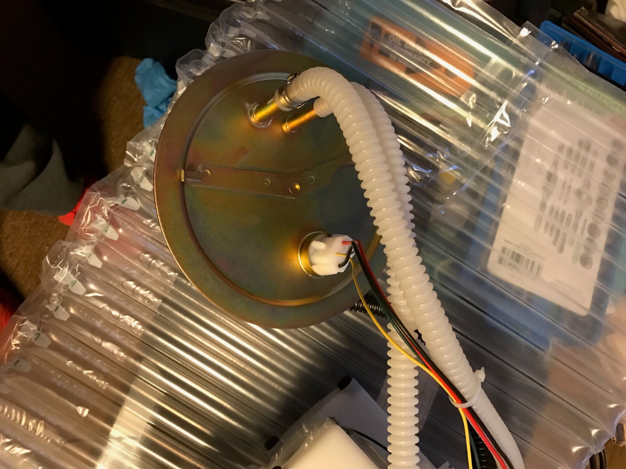

Here's the bad pump.... That damn retainer cap on top was a pain in a @$$
Tank finally out
Here's the new pump..
Something's not right. It's missing a connection on top

Did I order the wrong pump? or do I have to modify the new one?

What brand did you order? There is a difference in the pumps between the Cali-spec Excursions and the non Cali-spec ones...

the manufacture is AIP electronics. I ordered it from amazon. The one I pulled off has an extra port with a sensor attached.

I had exactly the same issue with mine, original was a California pump assembly with the integrated vapor pressure sensor (that is the extra part) and the first replacement was a non-Cali model without the sensor, just like you got. There should be a sticker on the underside of the hood that denotes if it the EX has Cali emissions or not, my rig is missing that sticker. You will need to trade pumps for the correct model to keep the computer and check engine light happy.

My Ex had no signs of being a Cali-spec rig, yet it still took the Cali-spec pump when I did mine a few months back. Used an OEM MC unit for piece of mind.
