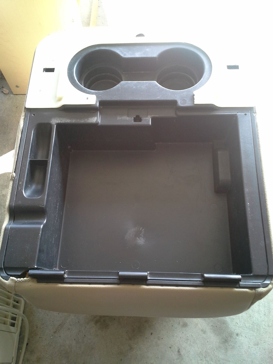

I just bought a jumpseat/fold down console to install in my Excursion. I got it from an 04 F350 Lariat. I also was able to grab the passenger seat with power adjust. This is what the console looks like now, after I took the lid off to see if I could repair it or re-glue the vinyl back under it.
NO CHANCE of fixing the lid. Someone put a lot of weight on top of it at some point and broke the lid all up. Also, the padding around the cupholders was peeling up around the edges, so I pulled that off as well to see if I could repair that. That cup holder padding can be done, but not by me. I am buying a replacement pad off eBay from a retired upholstery guy in Houston. His product looks good.
That leaves me with the lid for the storage area. I have spoken with a very good wood worker near me, and he says he can make me a mesquite/pecan/cedar...whatever I want...lid to replace the broken one. He took mine and is working on a prototype to test fit on mine and work some bugs/details out. No idea what cost is yet till he makes the prototype and figures out cost to him.

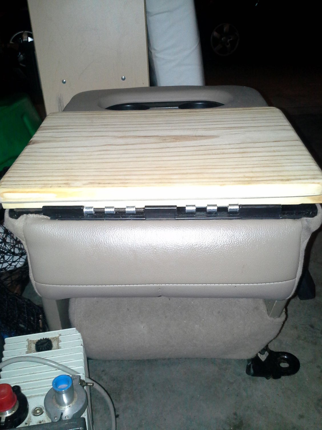

Have some photos of the prototype lid replacement. Will be visiting the wood shop to refine it a bit more tomorrow.
Will be taking a 1/4" off the thickness to lighten it up a bit.
Super easy install. Just slide the hinge pins back in from the sides.
And I get to keep my factory latch!
Just need to work on finding a finish that will match my interior wood trim.

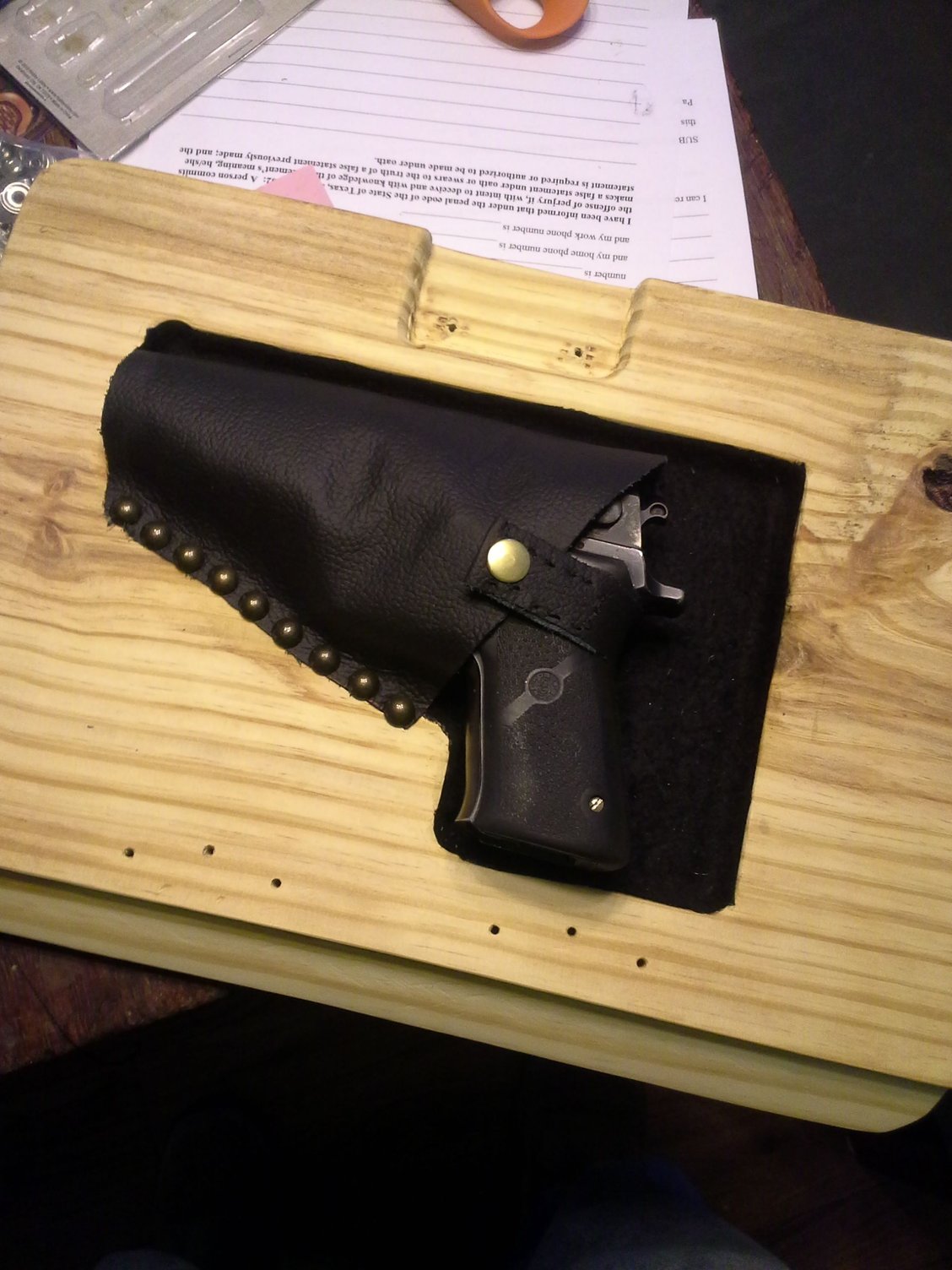

More progress on the lid:
Yes, the stitching was quick and dirty. Just wanted to make sure it works, and it works great with the recess cut into the lid. "Hardware" is tight and doesn't move around.

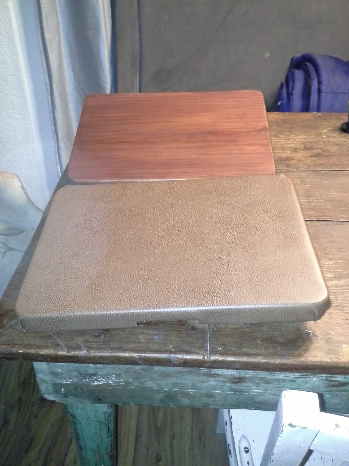

Two lids done. Can change with my mood now, since the switch out in about 30 seconds.
That is an M&P on the bottom. Mod. 410 on top.
One stained; one covered in vinyl.
Obviously no hardware installed yet. Might be putting the console in this weekend for "in-the-truck" pics.

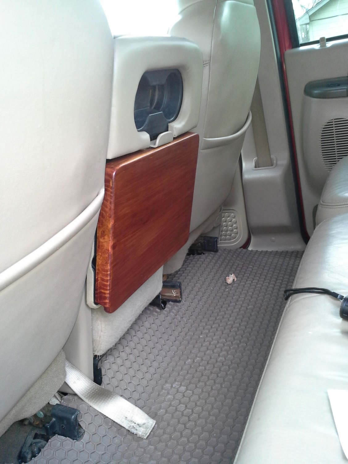

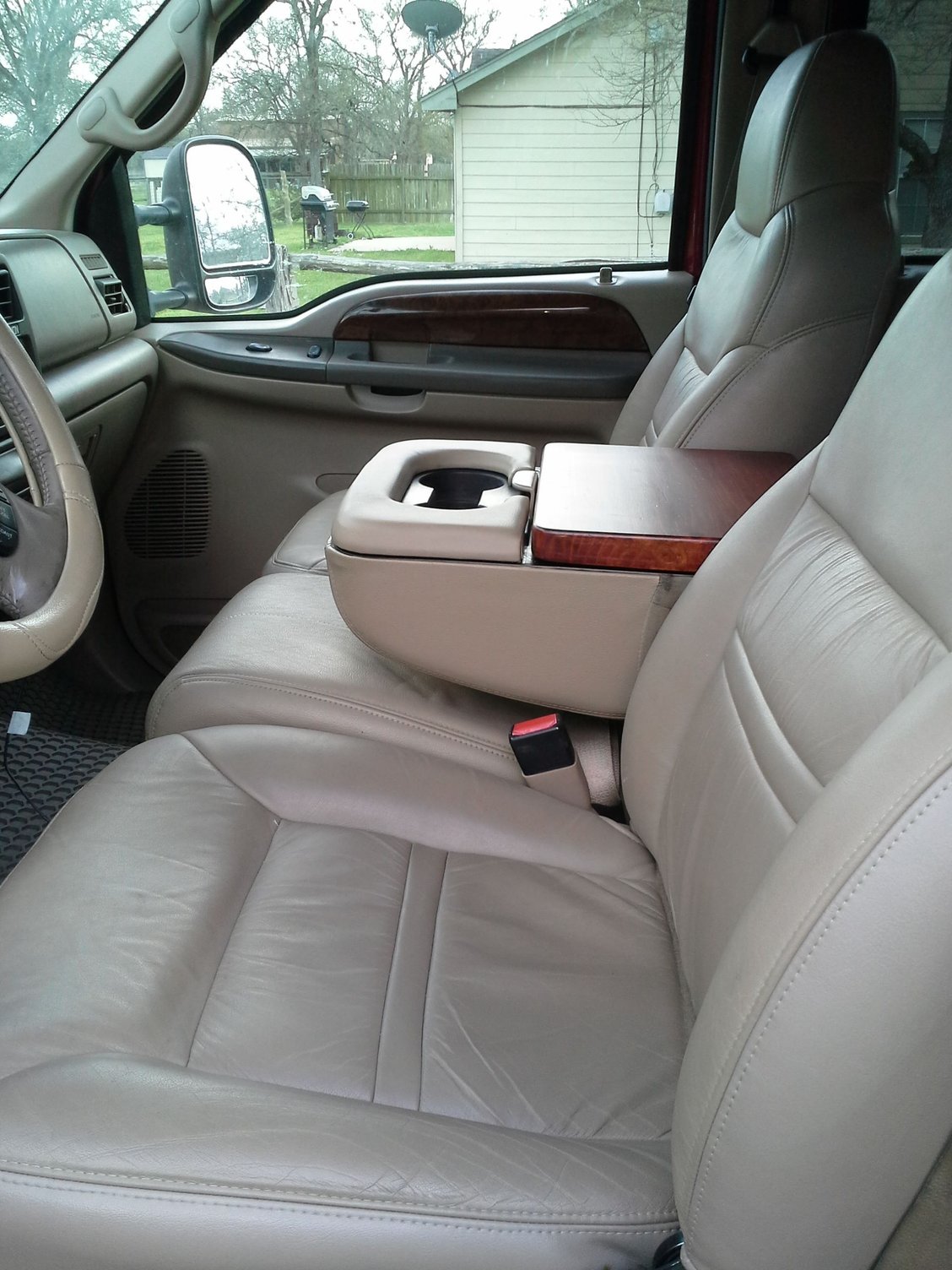

Got it installed today:
Still debating whether to engrave the top with something, or to inlay a Ford or Excursion emblem.
