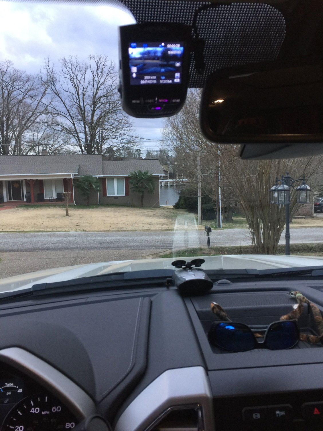

Put it here and you get the added bonus of disabling the lane departure warnings...

Why does it disable the lane departure system?

The dashcam (Viofo A119) is right in front of the lane departure camera in the rear view mirror and blocks its forward view. I wasn't really paying attention when I stuck the camera on there but realized later that steering wheel shake had stopped. That is the one and only safety system on the truck I didn't really like so I haven't re-positioned the dash cam yet.

When deciding where to mount, also check the sweep of your wipers. You'll want the camera within the sweep area. I didn't think about this until the first rain after I installed.

Wipers is a great point. You definitely want the view to be through a clean portion of the windshield. I was thinking about that when I mounted mine but didn't think of the lane departure camera is inside the left front of the rear view mirror. Some folks mount on the right side of the rear view mirror and others put the cameras below.

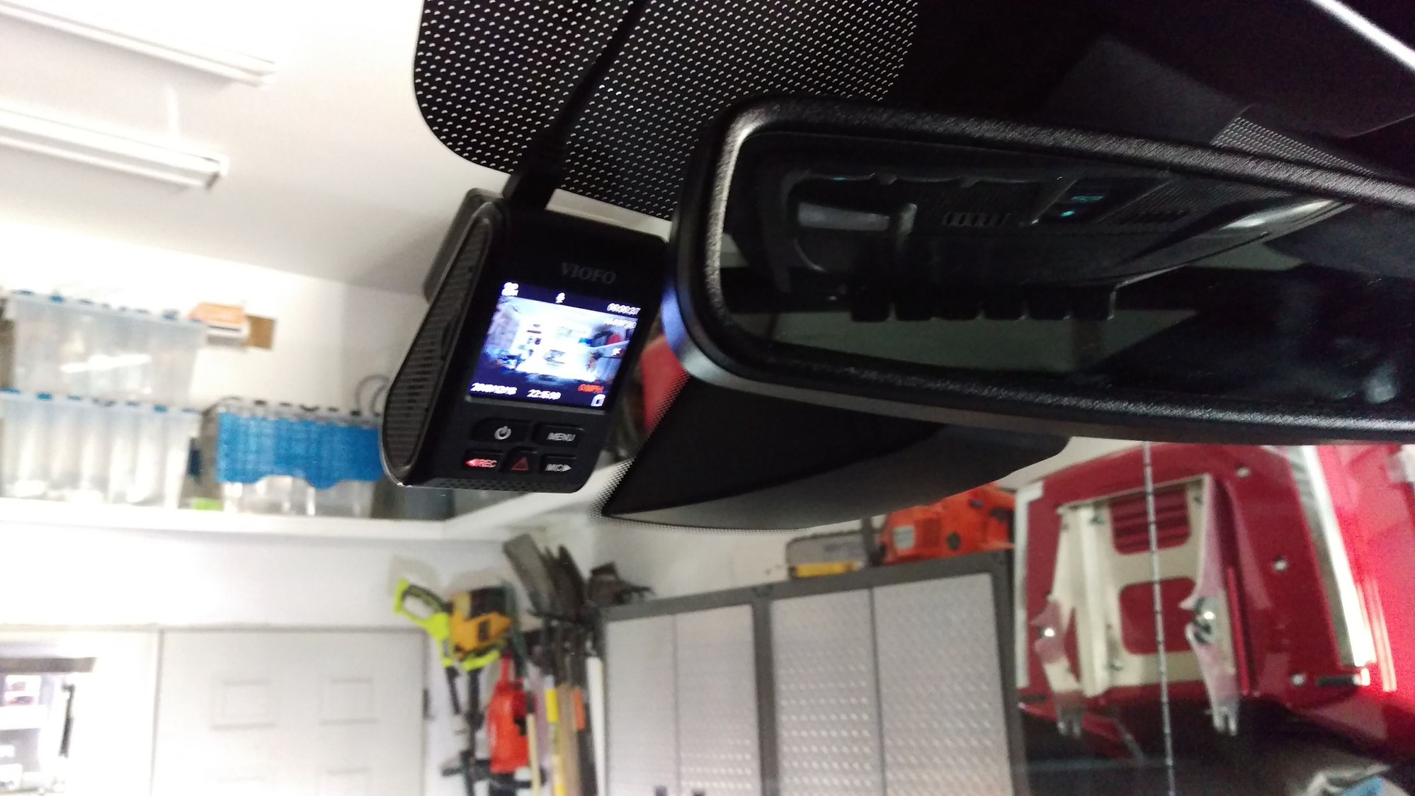

I have the A119s mounted on the other side, behind the rearview mirror. I placed the sticky part on the shaded area. Great camera so far.
